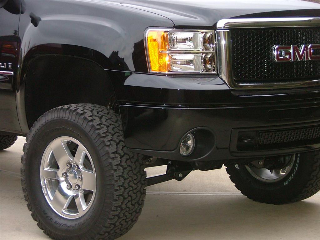

Nice Before and Much Better After, Looks really Good. :sick:
