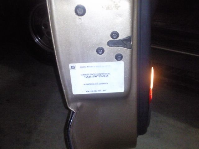

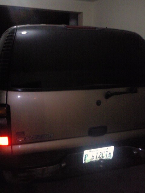

Got any pictures of this truck? I'm betting it is a GMT800 with some sheetmetal revisions. Since EPA rules aren't followed in Central America, it's gonna be just a guess on our parts as to what type of program to go with. I'd imagine you would have to go with a local custom tune to do that.
Here is an 04 Sonora. I like the fact that it had the US Chevy pickup front end on it.
Post me the VIN....I'll run it and get the model it is for sure.

pics...
That is a GMT800 Tahoe here. It still should have the 5.3 if it were an American market car. Interesting combination if it has the 5.7 there. 5.7 was and is a great engine. I'd say a custom tune is in order. It should have a 4L60E transmission and a GM 8.5 10 bolt rear axle assembly..
Wow, those pictures clearly show that the engine is not a 5.3. I had no idea they used the older V8s in the 800s. Power ratings are probably the same as the 400s: 255hp 325lb-ft.
