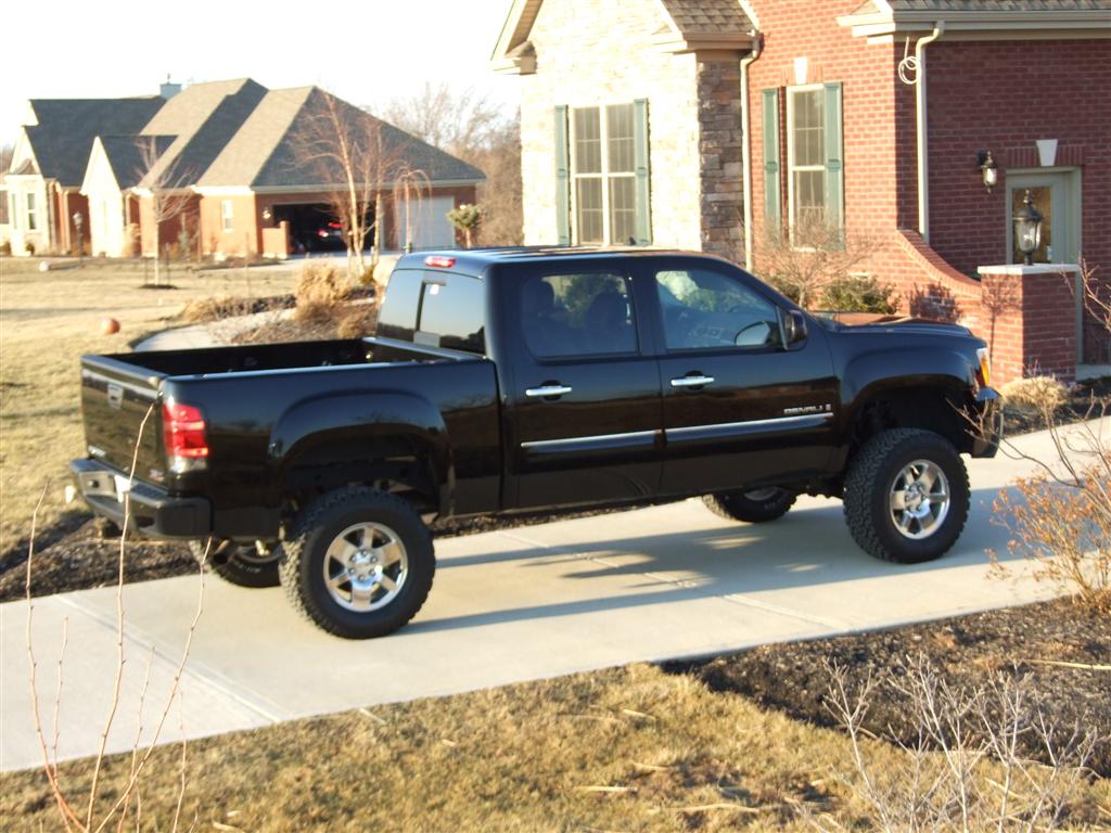

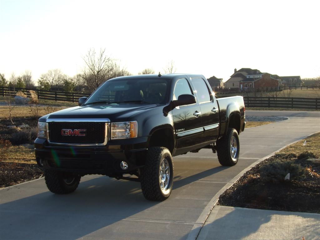

I have the Superlift 6" suspension installed on my Sierra Denali. Lift and alignment along with ride is A-OK. B U T, it has a much wider turning radius. I don't like it at all. It seems like docking the Queen Elizabeth! Comparing it to my H2, the Hummer turns in maybe half the distance.
1. WHy did this happen?
2. What can I do to correct it?
