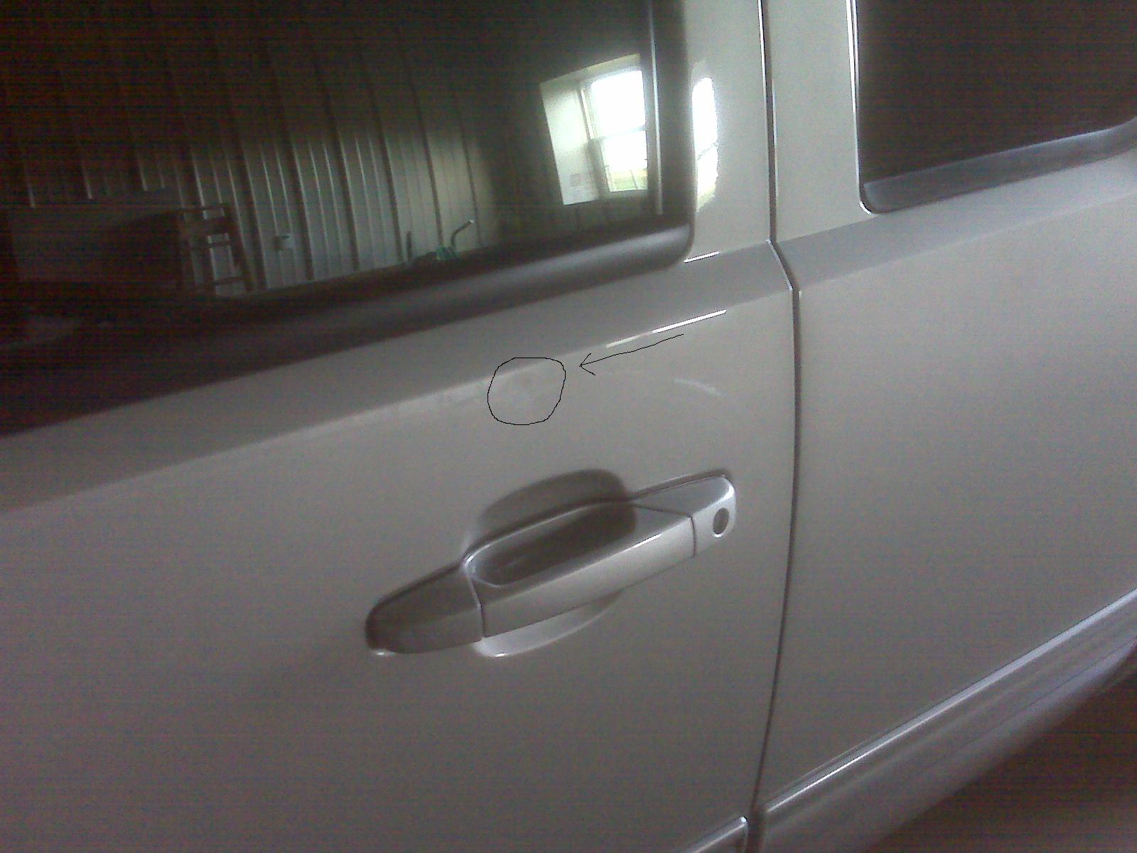

Little Dent Help...
+1 that definitely looks like a candidate for PDR. However with where the dent is, the PDR tech may have to drill a hole to get the tool in there. It looks as though it may be under a structural brace in the door, meaning there'd be no other way to get at it.
Taking the door panel off may prevent having to drill a hole in the door. Paintless dent removal guys use S hooks which they can secure to the inner part of the door for leverage when they use a bar to push the dental metal out.
Definitely do not try to fix this yourself. It is trickier than you think.
