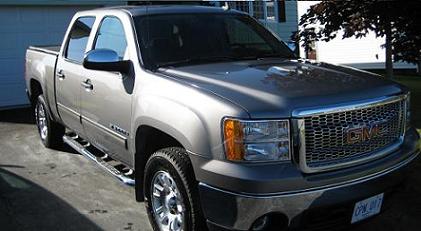

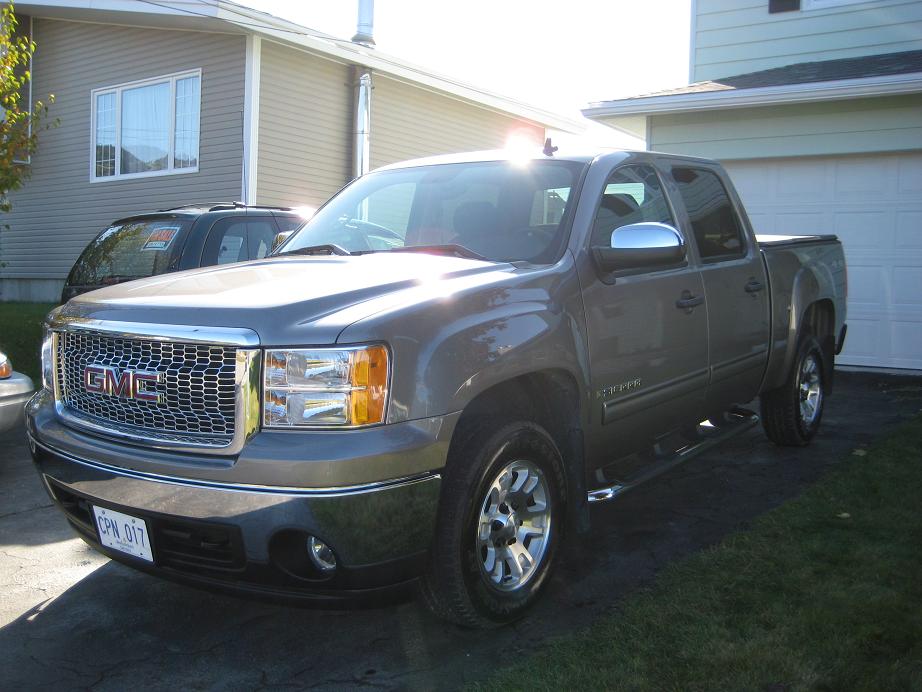

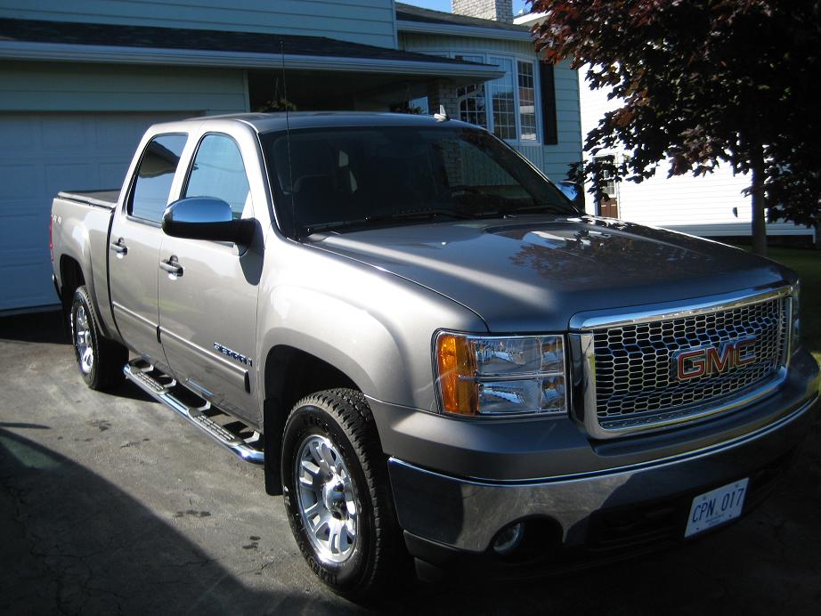

Well it was some pretty miserable weather yesterday and today, but at least it wasn't raining today.
Got it all done, took a while, but wasn't that bad.
Was covered in the usual mud before I started.
Was pretty dull out when I took the pics combined with my awesome camera skills don't make for the greatest shots, looks better in person.
Also had to resize them a bit...
