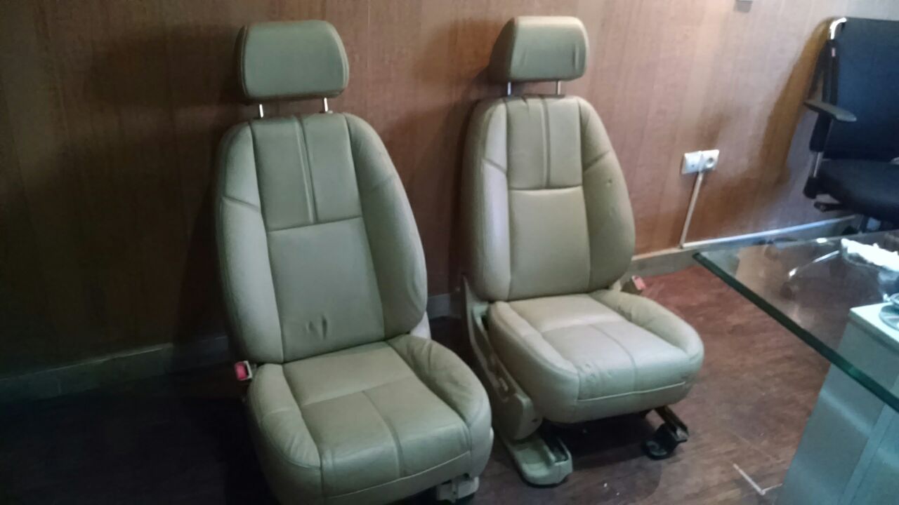

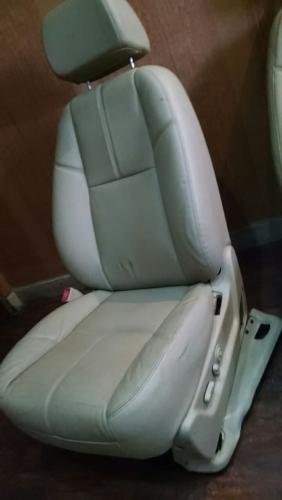

I`m Arad and need help for install two electrical front seat of 2007-2013 chevy tahoe or suburban or avalanche. I have some question about that and wiil be happy if some one can help me on this way.
1- Can I have wiring diagram of front seats? (picture attached) link of pictures: http://www.auctiva.com/hostedimages...,0,0,0,0,0,0,0,0,0,0,0,0,0,0,0,0,0,0&format=0
2- I checked socket of seats and find two bigger wire(Red/white and black). I think main power wires are them. But when I connect 12v adapter to wires nothing happened and no movement.
3- I know the seats have many function. But I need anly movement and heat/cool function.
Thanks for reading my post.
