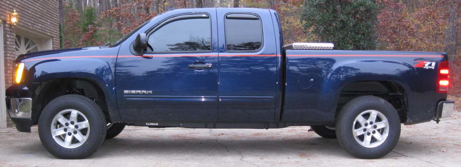

BEFORE THE CCM 2.5" LEVELING KIT: :)
AFTER THE CCM 2.5" LEVELING KIT: :)
THEN WITH PROPOSED TIRES & WHEELS. HELO MAXX 6 (front) versus MOTO METAL 951 (rear)
WHAT IS YOUR PREFERENCE????????????
