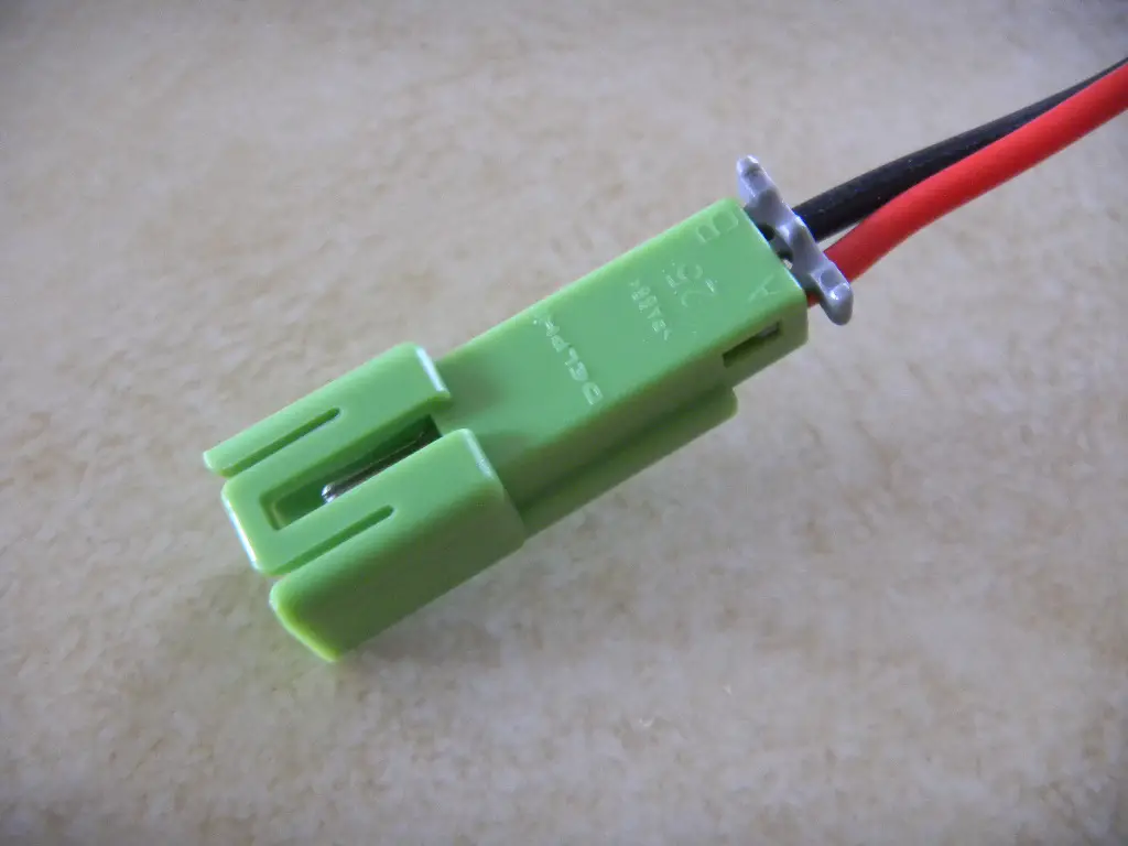

Do not buy the harness P/N 25807858 all it does is get you the lt green connector to plug in to the SIR coil's lt green connector. You will find that your truck's harness will not have a 12v at the next connector "up stream" from the lt green connector of this harness.
Not sure on part numbers, but as others have stated in this thread, you don't really need to spend the money on the harness. It is very easy to to run a positive and a ground wire, so that you don't need the harness.
Agreed, you do not need this harness. You can cut off the lt green connector and run your own 12d grd wires, or there is a "plug & play" hrness for sale in the classifieds of this Forum. post-132989-0-29093700-1455115961_thumb.jpgpost-132989-0-56663700-1455116027_thumb.jpg

placed an order for a plug and play harness (green connector jumper wire) from Zebrafive...
