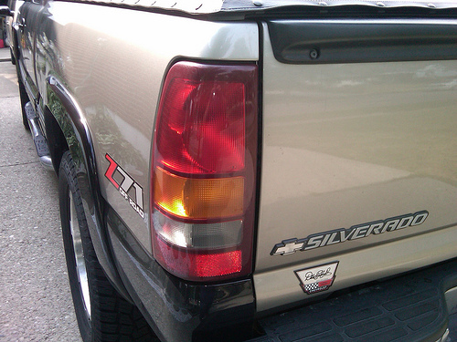

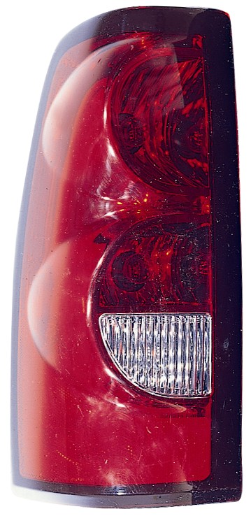

not sure if you can see it or not but look a the main red light on top...inner lens is different
I'm kind of confused. Don't the tail lights on the older silverado's look just like that? I don't notice any difference at all. :)
Here is the difference of them the first photo shows the new ones and the second shows the old.. The old ones have 3 bulbs and the new ones have 4 because of the side marker.

If you can, get a closeup of the side of the older one so he can see the "opening" directly from the side...that inner housing is the main issue. I didnt know that you could grind the openings to retrofit but it does make sense
