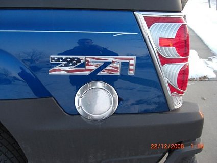

You are missing the Z71 decals, that's the problem. Make sure you order the set that say 4x4 so that you get that added performance! lol
Already here. LOOK! lol....By the way how did you add bluetooth, dealer say can't
