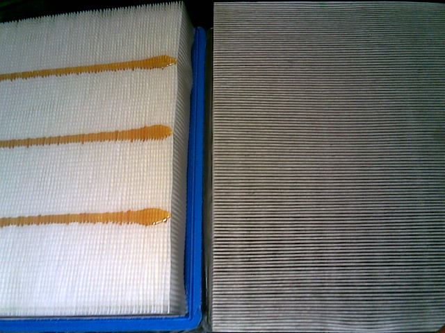

Acdelco Filters, What Is The Differnece/which Is Better?
Acdelco Filters, which Is Better FLOW??
Black A1518C (used)
Blue A3086C (new)
Not sure about flow, but the blue one looks cheaply made by comparison to the black one.

Thanks, it looks like the blue is less efficient, it actually says efficiency 95.x% on the box. Because of warranty I am looking for an OEM part with better flow, you may be surprised that this blue less efficient filter is what is used with ALL new Cadillac EXT, Escalade?!! I assume these bigger engines (6.2l) are high performance?
I am curious!
I leaning toward the amsoil EAA air filter.
I replaced my blue one with an AFE Pro-Dry S drop-in, and really like the quality of it. And it doesn't mess with the MAF sensor.
Isn't the blue one the high capacity one? Thought the glue lines down the pleats was the give away for that.

no its similar to the one on my Tahoe 5.3

This is from 2010_cadillac_esc_ext_owners_manual.pdf
Maintenance Replacement Parts
Replacement parts identified below by name, part number, or specification can be obtained from your dealer/retailer.
Part GM Part Number ACDelco Part Number
Engine Air Cleaner/Filter 15908916 A3086C
Oil Filter 89017524 PF48
Spark Plugs 12621258 41-110
Wiper Blades
Front – 21.6 in (55.0 cm) 25877402 —
One filter is high capacity and used in the Z71 off road option.
A3086C is the standard duty air filter
A1518C is the heavy duty air filter option "K47 High Capacity Air Cleaner"
You can use the A1518C in place of the A3086C as they are identical in lengthxwidth, it has more pleats and they are a little longer, so it can hold more dirt and that's the only difference.
The filter box is the same so either filter will fit.
