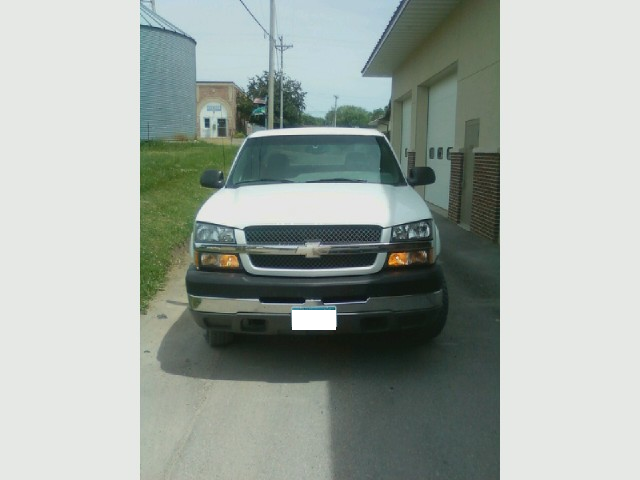

Thanks to both of you guys! Got some stuff to do here before it rains, and then i will take a look at it! I did the amber bulbs in the work truck today. Hopefully get some pics up tomorrow, and do mine here sometime this week!

I used the Napa bulbs, 3157NA's whatever brand Napa stocks. For mine at home I got the Sylvania bulbs, 3157/4157NALL's i believe they were.
Here is a pic of my work truck with the amber DRL's:
