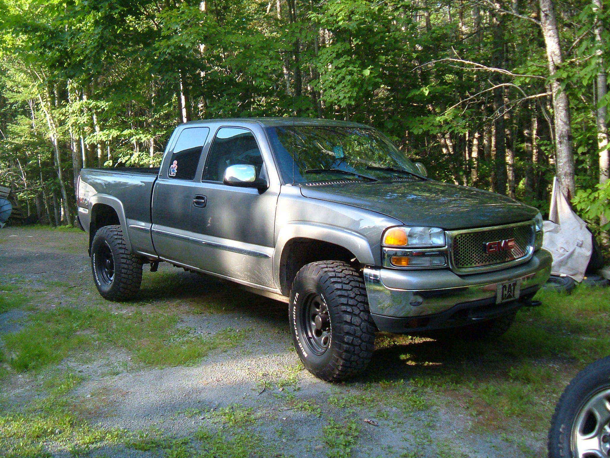

truck will haul it fine, the brakes are a must and would definitely recommend the weight distribution and mirrors. I haul a 32ft travel trailer with double slide outs that weighs 7500lbs dry and empty, probably about 9500lbs on the road with my 01 with 5.3l, 3.73`s and 35`s on it, have aftermarket trans cooler and gauge of course and truck definitely works but has survived so far, the 6-speed would make a huge difference. Just take it easy and don`t drive it like a race car.
