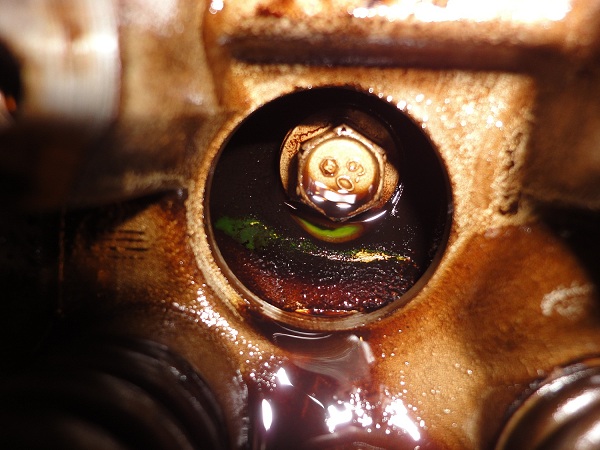

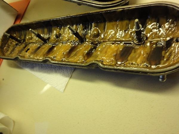

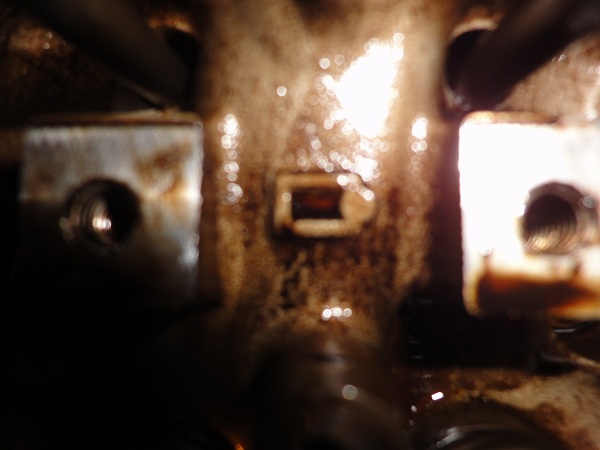

I own a 2004 GMC SIERRA with the 5.3L. I was experiencing "gradual coolant loss over time with no apparent cause" and just verified that I do have the "castech" heads which are BOTH cracked in the prescribed area as per GM service bulletin ##06-06-01-019B.
It seems that more and more of these cases are occuring and General Motors needs to take responsibility!
