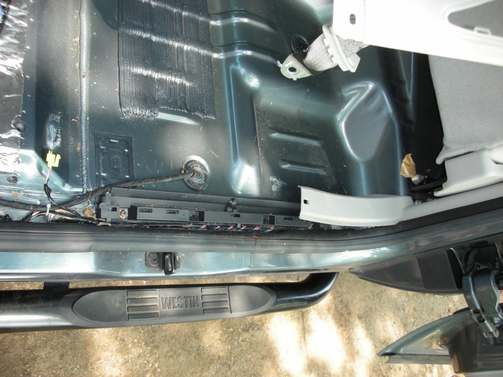

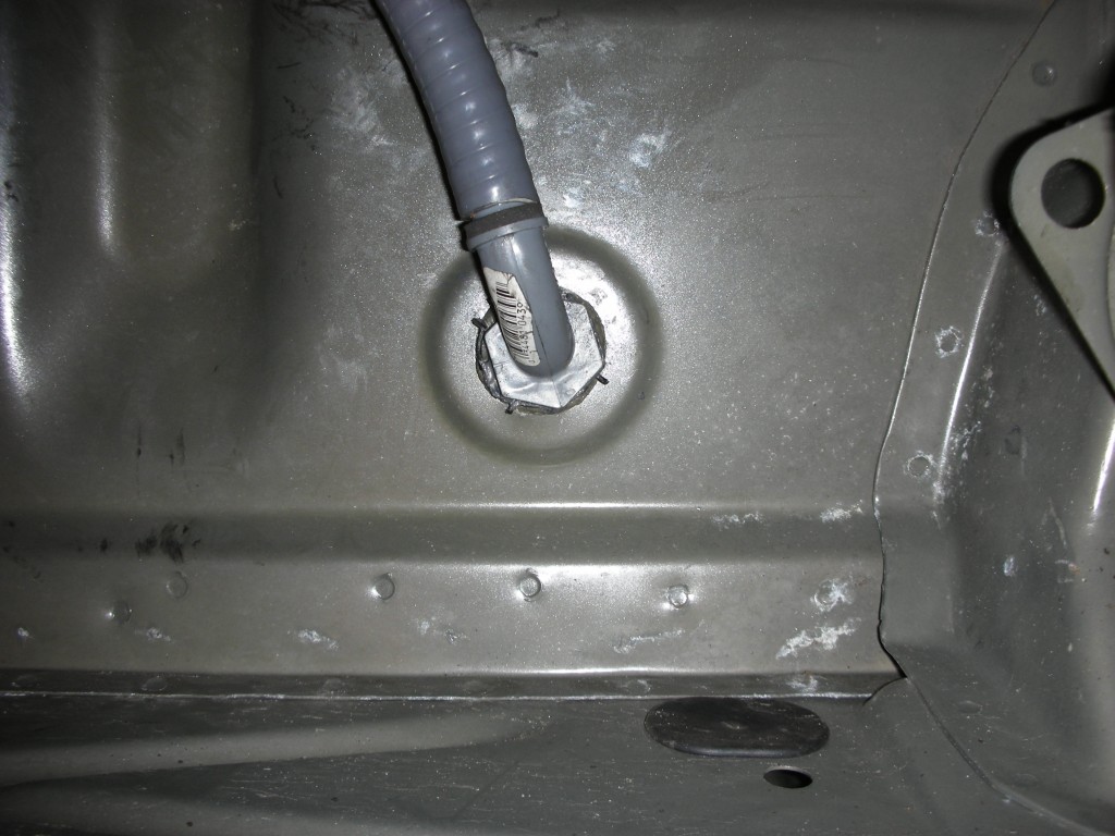

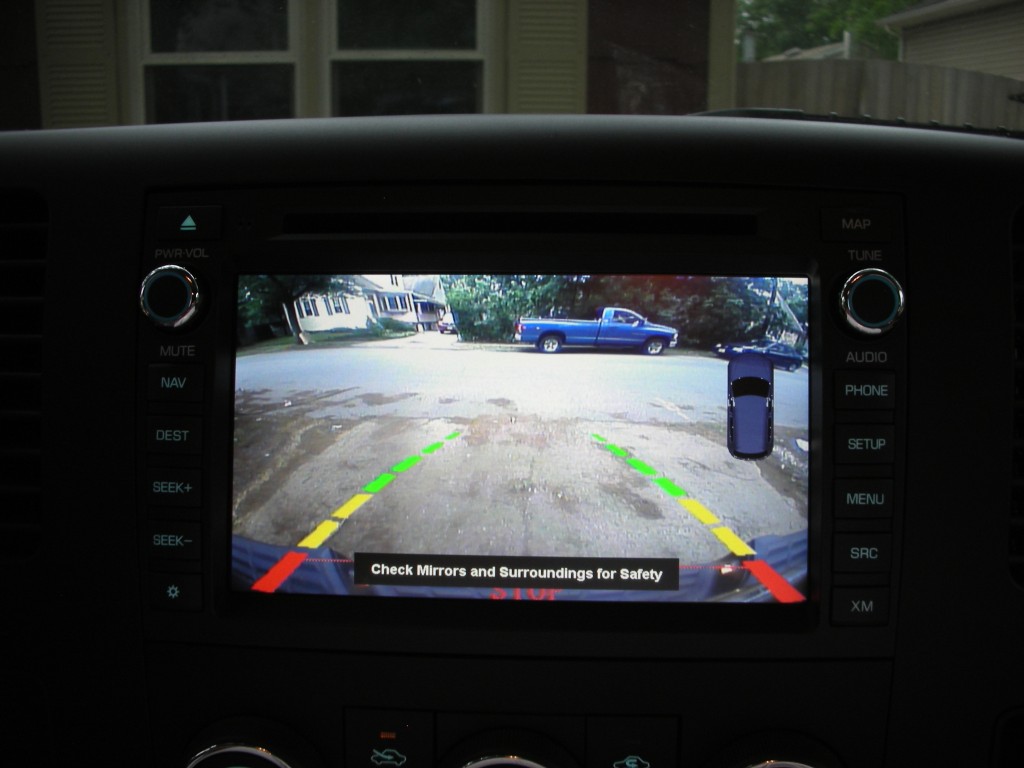

Just thought I would give back a little for any of those interested in a rear-view camera install. I finally get my replacement head unit for the first one I got which was a dud. ADC is great and are really a nice bunch of guys but I think they still have a lot to learn about dealing with internet sales. Should not have taken 2 weeks to get me out a replacement and I had to really get on them to keep it that quick. Not saying I wouldnt buy from them again, I definitly would, but if you have to do any type of exchange, stay on top of them!
Anyway, attached are some pics. I ended up getting a kit from this guy:
http://www.camera-source.com/2007-2012-GM-...-GM0712-CCD.htm
He also sells on ebay. Was a little nervious buying from an "ebay" seller but I figured how much different could it be from any other aftermarket shop. Also, he claimed that it is a higher res lens being that it is CCD and not CMOS. One key thing is that I can see my bumper through it which helps when judging distances. Also, it has a quick release cable at the tail so if you need to take of the tailgate. He was very quick to respond and me his cell in his email in case I had any trouble.
The camera when it fairly easily. I ran all of the wiring to the dash. Made a hole for them in one of the plastic wire blanks so I didnt have to drill into steel under the cabin. I also ran the part that is under the bed through AC conduit so it is well protected. Had to find a reverse source for the 12 V(+) in the dash since the green/white wire on the OGM1 is NOT an output, it is for input. But once I did that, the rest was easy.
