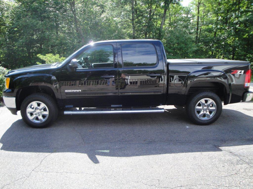

So here is the truck stock from the dealership.

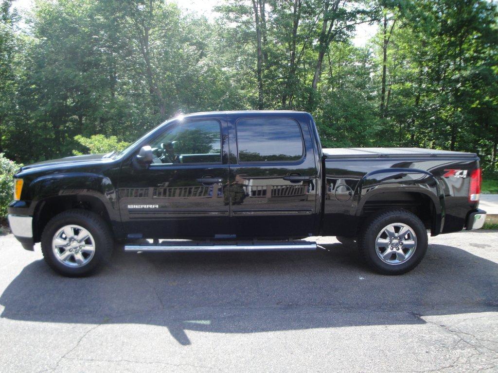

It occurs to me that I put 'lift kit' in the subject line when I meant 'leveling kit.' So anyway here is the truck with the Rough Country Leveling Kit. Actually a pretty easy install after watching the Youtube video.

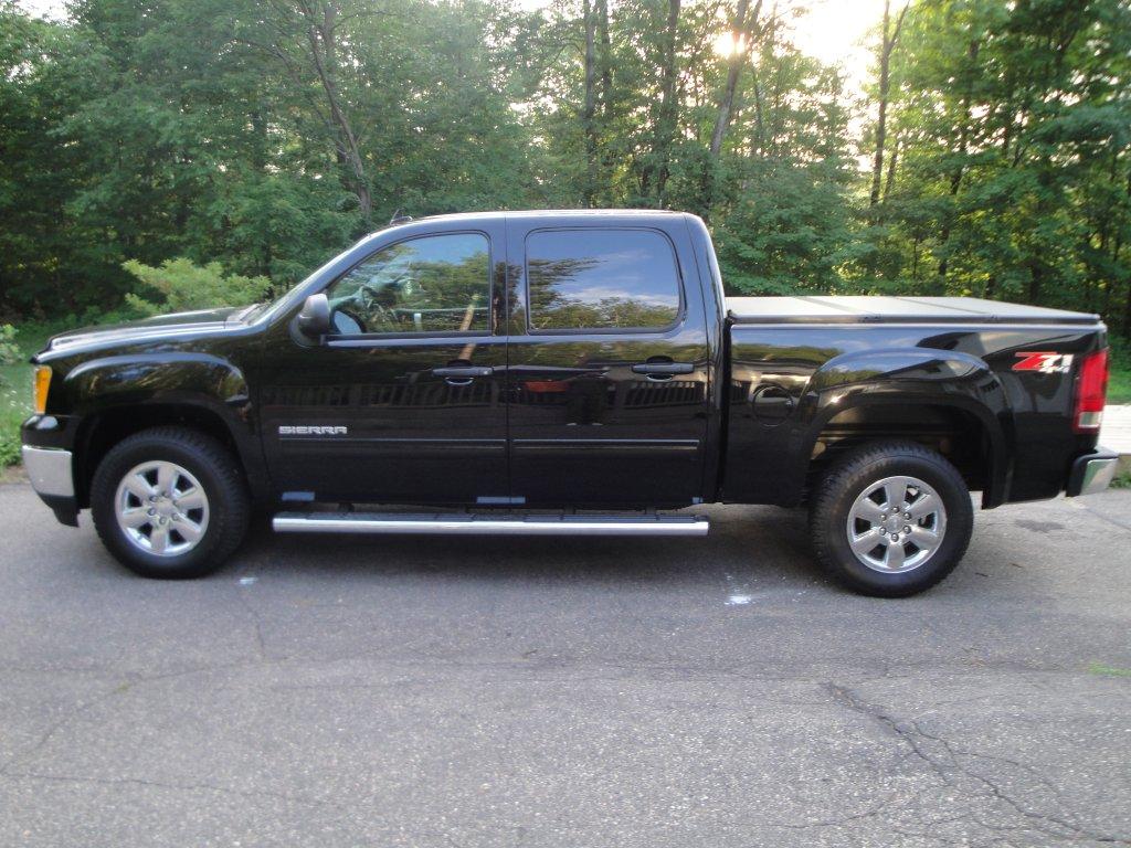

Here is the truck with the Readylift 2.25 inch blocks in the back to restore the rake (for those odd occassions when I tow the camper or make a run to the big box store for plywood and drywall). I also swapped out the rear shocks for the Bilstein 5100 levelling shocks that I pulled off the old truck.

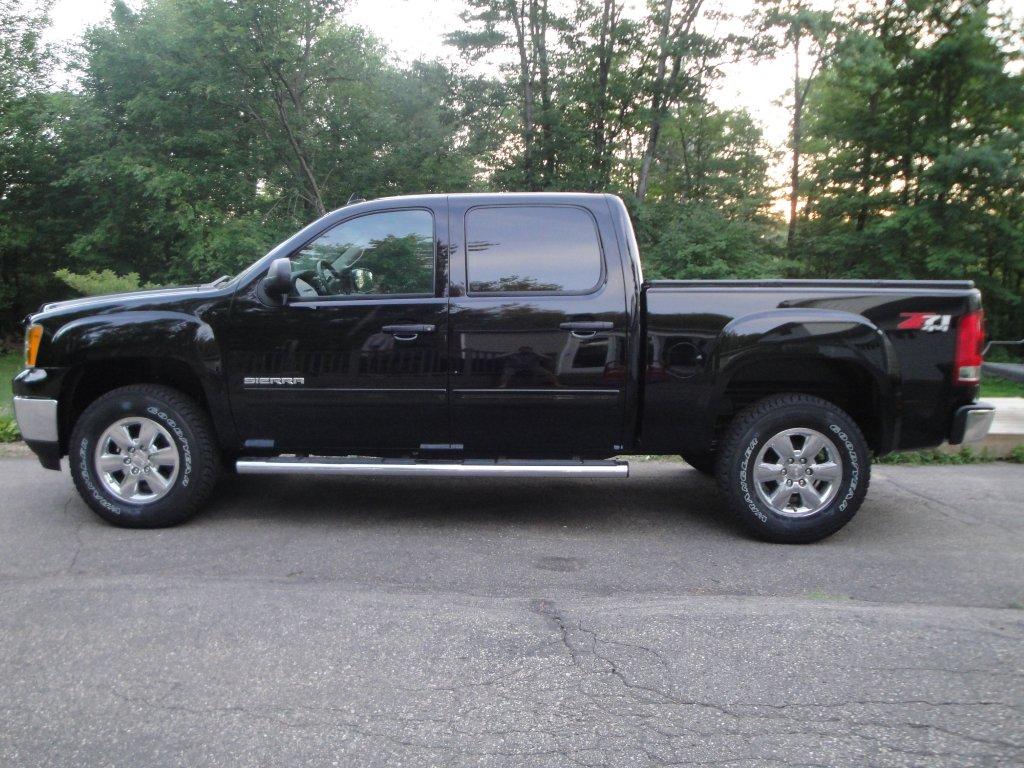

Here is the final product with the new tires. Upgraded to 33s. Goodyear Wrangler Silent Armor Pro Grade LT275/70R18. Felt it was a good compromise from a true off road tire that wouldn't shake my kids teeth loose on the highway when we go to visit the grandparents. Pretty happy about how it all turned out.
