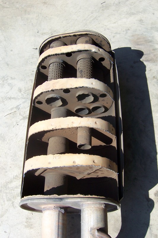

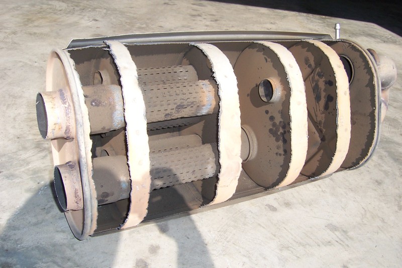

with that setup you can tune it to remove the drone at certain rpm's by increasing/decreasing the tube lainth . the longer the pipe the higher in the rpm range the drone will be canceled out.. this is how GM addressed the drown issue on the 6.0L..
the stock muffler, (03 SS muffler) is not a true DI/DO muffler. the drivers side exit pipe is just a dead hole, works the same as above but looks a hole lot nicer.. :D
