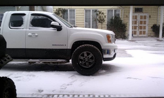

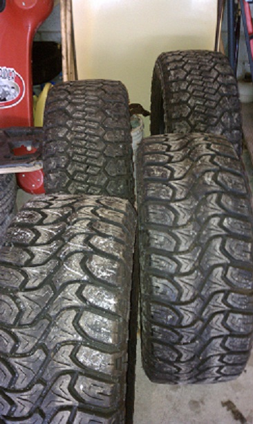

i got some new to me tires (305/55/20) at a deal i couldnt pass up. now ive searched for 2 days and i cant seem to find what offset i should run on a 20x9 wheel to have my tires stick out passed the fender a little. i mean i know -12 and 0 offset make the tire stick out passed my fender, but i just ordered bushwacker pocket style fender flares and i want my tires to stick out to fill them up. not be tucked in like factory wheels and look gay. so is there a happy medium with offset's between sticking out of the fender a little and not rubbing? i have a 2'' leveling kit and a 3'' body lift. here are a few pictures. thanks for your help, btw the wheels i was looking at ordering have a +18 offset, but i dont think they will stick out enough

Actually, just the opposite...rims with a higher offset (like 31mm) will be tucked inside the fenders, while a lower offset (like 12mm) will put them about even with the fender opening. A 0mm offset or negative offset will kick them outside the fenders.
A rim with a zero offset, means that the mounting flange is in the center of the wheel. A positive offset means that the mounting flange is shifted past center, to the outside of the wheel, which will bring more of the wheel inside the fender opening. A negative offset means that the mounting flange is shifted past center, to the inside of the wheel, which will push more of the wheel outside. The exact distance from center is measured in millimeters.

You are correct sir, how then is the stock Yukon Denali rims a 31mm offset as stated by GM? my stock rims appear to have a solid positive offset, that is not much of a lip, far from (to street side) the rims center.
Thanks in advance.
Yes, that is correct. Your rims have a positive 31mm offset....which means that the mounting flange of the wheel is pushed 31mm to the outside of the wheel....so over half of the rim's total width will be inside the mounting flange...which you can't see. This design will reduce the amout of 'lip' or 'dish' as some call it, because there is less rim on the outside. Rims with a negative offset are just the opposite...they have that 'deep dish' look. Hope that makes sense.
No problem! :thumbs: All of that rim offset and backspacing stuff used to be very confusing to me, until I made myself learn it, lol.
