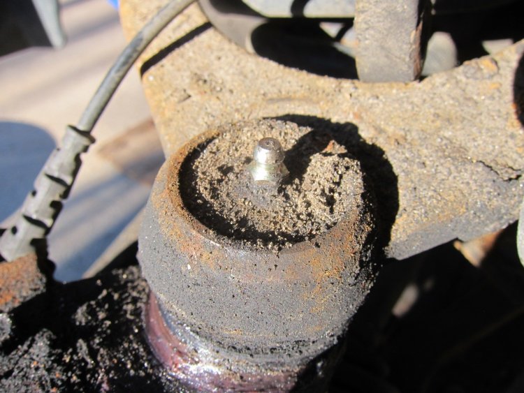

That's just crazy.. Something's gotta be wrong there... Nice work on the zerks!
Sent from my SM-N950U using Tapatalk

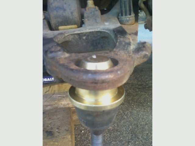

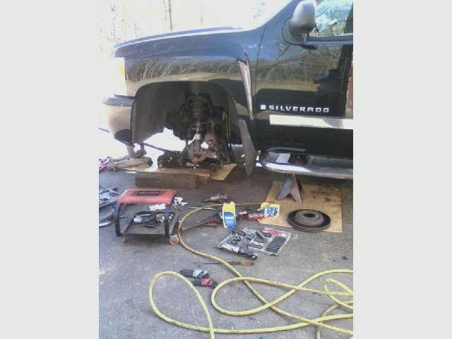

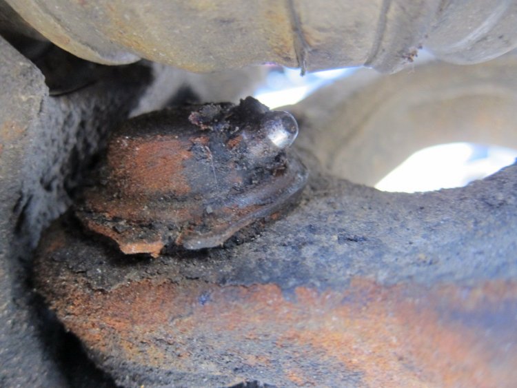

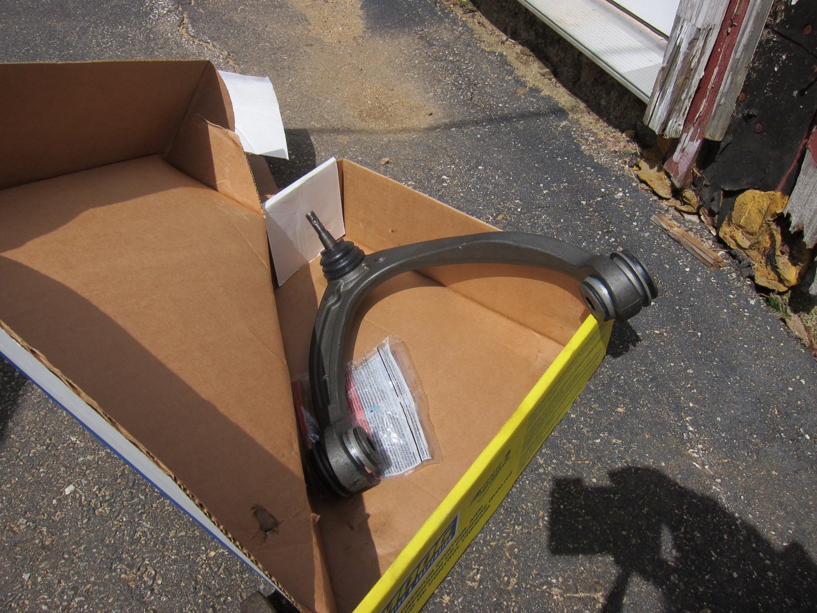

Just GM being cheap - used crap, low-quality metal for the rotors. Things would shake your fillings out right off the showroom floor with 42 total miles on the clock. It was ridiculous. All through every repair, the pulsation would come back ... until I threw a set of EBC rotors (not slotted or drilled) on there with the Yellow pads. Been great ever since.
The ball joints were another debacle. Lowers failed at 38k, uppers, along with the hub bearings & one strut failed at 50k miles. Replaced everything with Moog (and Bilstein struts), and that has been trouble free since.
