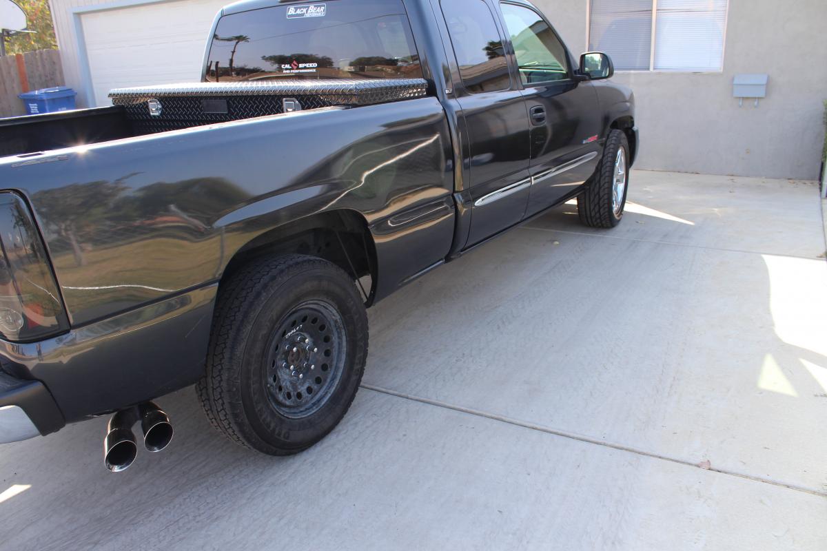

Right rear tire that is 24 days old and has about 1000 miles on it

Yea. I couldnt get over for half a mile. Right now I have a 265/70R17 firestone destination at on a 17" steel in its place

Here are pics of the tire. I was a pressure break. Apparently I ran something over on the highway and it caused a break in the tire. It isn't a puncture, but looks like one. If I was able to get off the road quickly the tire could have been saved.
Nope, the warranty covers treadwear for 50,000 miles and manufacturer defects. Tire Rack attempted to make it right even though it isn't covered by offering me 50% off of a replacement and waiving the shipping charge
