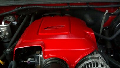

Started off with the engine cover. Should've put more work into this honestly, but it was sorta a spur of the moment deal. I really should've used some sort of primer, painted, cleared, wet sanded etc etc...but I just hit it with some Krylon Fusion Gloss Red. It didnt come out too bad really, also touched up the Vortech emblem with some black.

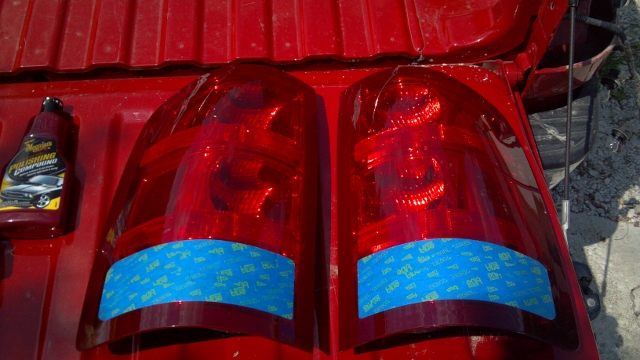

Started out by taping off my reverse lights since I did not want them tinted(I kinda like seeing when I'm back up...dont you?). They were a little tougher than I thought since the corners were rounded, but with a little paitents and a razor I followed the lines...ok.

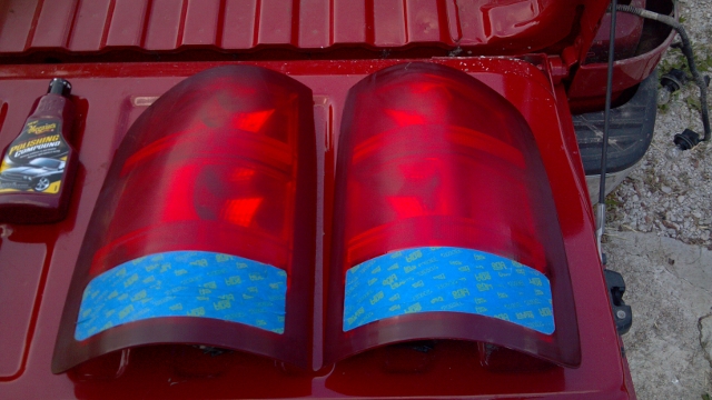

Next I wet sanded with 2000 grit sand paper and cleaned/preped them with naptha(I included the picture to give a good idea what you will see after wet sanding dont be alarmed you havnt ruined your lights...too much).

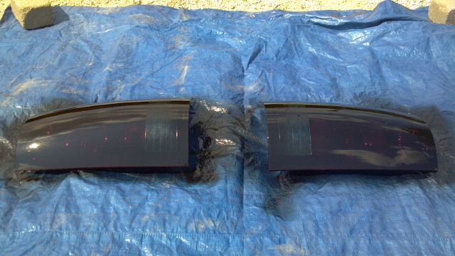

I decided to go with two coats of the night shades first shot is with one coat, second shot is the second coat.

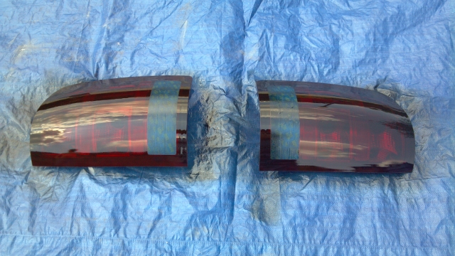

After that had dried for some time I applied three coats of clear. I let that sit over night before wet sanding and polishing. When I did I hit it with 1500 first then 2000, and on to polishing compound/wax. The came out just about like glass, although I wish I had a power buffer, would make the polishing step a lot easier. Anyway thanks for looking and letting me bore you with my mindless car stuff dribble haha.

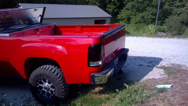

realized I didnt incude a pitcure of the finished product for either of them, sorry
The tailights look almost black from the right angles but when the sun is on them they look almost blood red. Also the tailights and brake lights etc are still very visible in all light.
