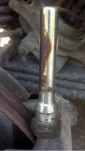

On the GMT-800's, if mine is any example, I have found that the caliper pins really need to be lubed well from time to time. Especially in the rear. Mine actually got ridges in them after a while and I had to get new ones. When I grease the smit out of them I have no noise. I was having the same thing as you (squeeking when not applying). Try greasing the bejeebus out of your caliper pins and see if it doesn't go away. Use caliper grease.

Did this solve your problem? I had to do my rears today. Look at the pics to see what I mean. This might be more applicable to the 99-04's wth the rear disc brakes (I've never had the problem with the front brakes. You can see the scoring and heat discoloration from the metal to metal contact. This is after I wiped them off good (there was some lube left on there after I took them out of the calipers). I've already replaced them once over the course of the life of the truck. (164k miles)
