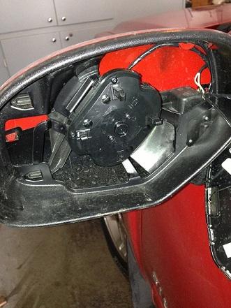

I am 6' 4" tall and found the drivers mirror to be unuseable due to poor range of movement. I removed the glass with a 4" putty knife from the bottom up. I then removed the 4 T10 screws out of the puck motor. I installed 4 flat washer 1/8" diameter under the bottom and right mounting screws. I installed the glass by running the bottom right side mounting pins out then latching them to the glass back. I then ran the mounting pin for the top and left side out and firmly pushed the mirror in place. This process took 15 minuets and it works great.

Ok let me alos say I have short legs with a 30" inseam. My head hit the roof while sitting properly. I will work on geting the pics included. The dealer I talked with said he has many tall customers with the same issue.
moving the seat is not a solution as, It will not go far enough down. Nice try.

But the steps I mentioned at the begining are what I belive will be a help to others, a true low cost easy solution. I was not able to find this information anywhere.
