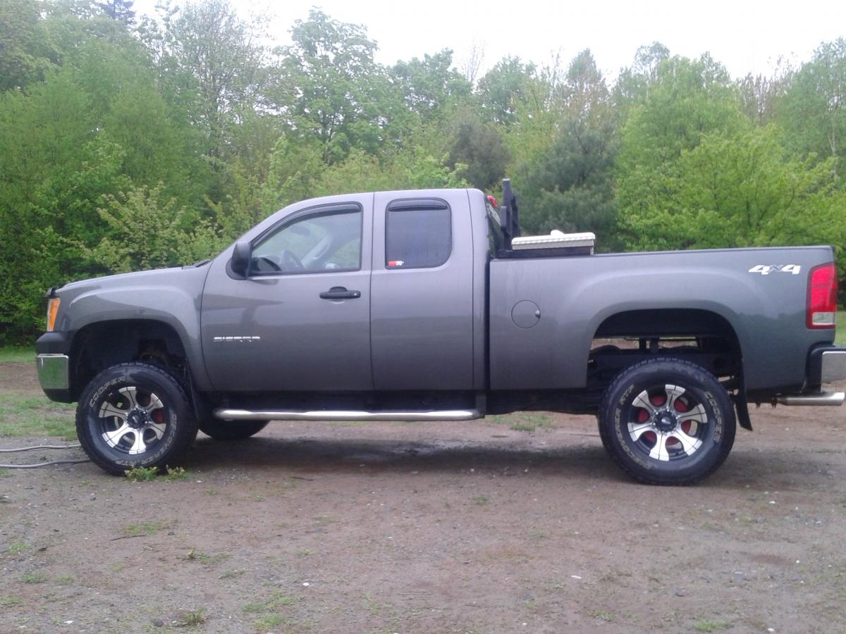

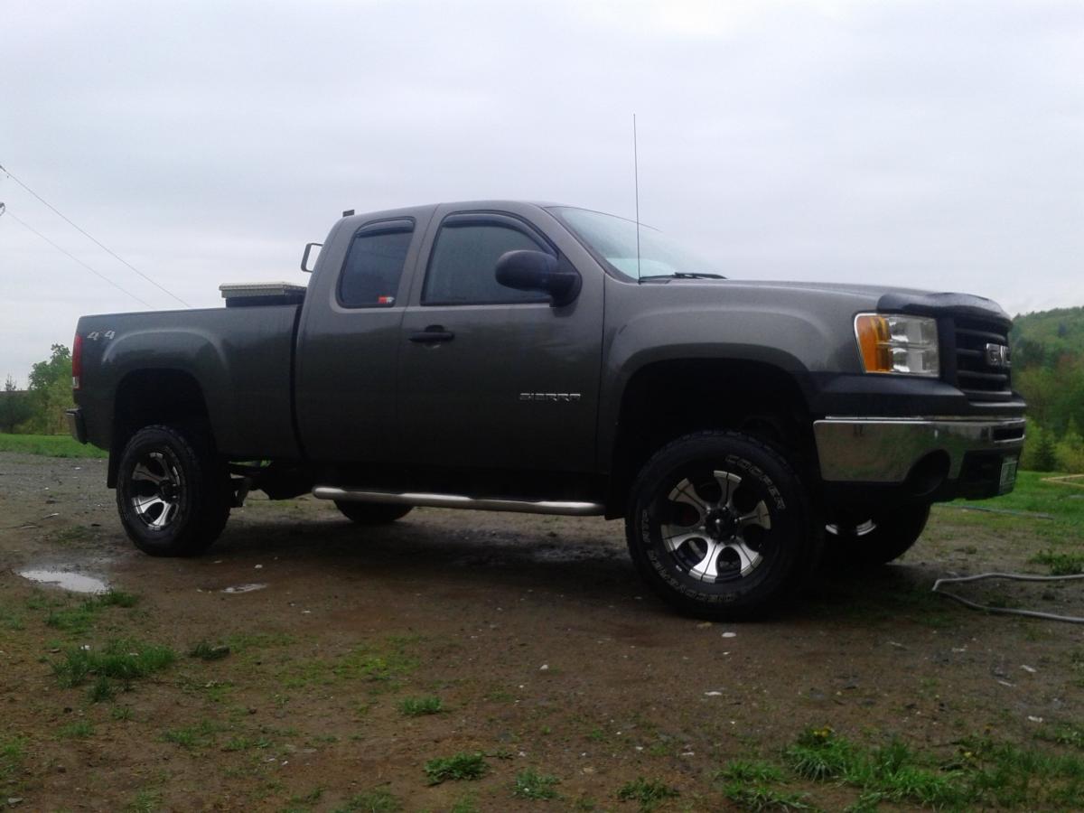

finally got to install my 3" BL on my truck today with the help of a buddy (the same one that we installed the budget 4" lift last weekend).
The kit fit like a dream, it was time consuming, it took the claimed 6-8 hours as its stated. everything fit perfect, the rear bumper fit like a glove. very impressed. this is my 3rd body lift install.
What i noticed for other people to watch out for when lifting with a manual transfer case. there is a bracket that holds transmission lines that the linkage hits and it will not go into 4wd, it goes into neutral just fine and thats about it... bend the bracket up about 1/2" or better and it works slick!
Second thing, anyone questioning about the transmission linkage, good news its a cable linkage, so no problems there.
If you have a CAI like i do (K&N) you will have to re route the radiator hose. it gets pinched in between the CAI and the frame.
Otherwise its a pretty straight forward install. it was absolutely worth going from a 1.25" BL to the 3"BL.
On one final note, if you just bought a new truck and are thinking about doing a BL in the future PLEASE take out all your bolts one by one and put never sieze on them. that way when the truck is 2 years old you wont have a stripped body mount bolt.
Need better pics
I 2nd this
