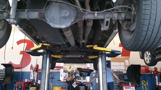

I have just installed duels on my 2012 Silverado, I love the sound, not sure if it has increased performance a whole lot but has seemed to help increase Gas mileage some (if I keep my foot out of it). I had the 3rd cat removed along with the resonator and had 2.5" pipes ran to (2) seperate Magnaflows (16") then out to back behind rear tires on each side, also had an X-Pipe installed to smooth out the whole deal, sounds excellant and roars when you get on it. No codes or odd problems and sound is a bit louder but minus the poping sound I had before with just a Magnaflow installed on OEM 3.5" exhaust.
Is that x-pipe after the mufflers?

OK, from that one pic I thought it was after the mufflers, I think it is supposed to cross with in 2' of the cats if memory serves me right for the best scavenging.

Attached are better pictures of how this true duel exhaust runs on mine. FYI
