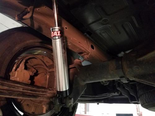

Got a shot of the QA1's last weekend. Had to use a couple of washers and grind down a bit off the mount so it wouldn't hit on the bottom but you get the idea. I'm running about 4 on the setting and it matches the McG's up front well. I prefer them at a 3 or 4 but the back gets too soft. I'll eventually switch the front to QA1 coilovers.
