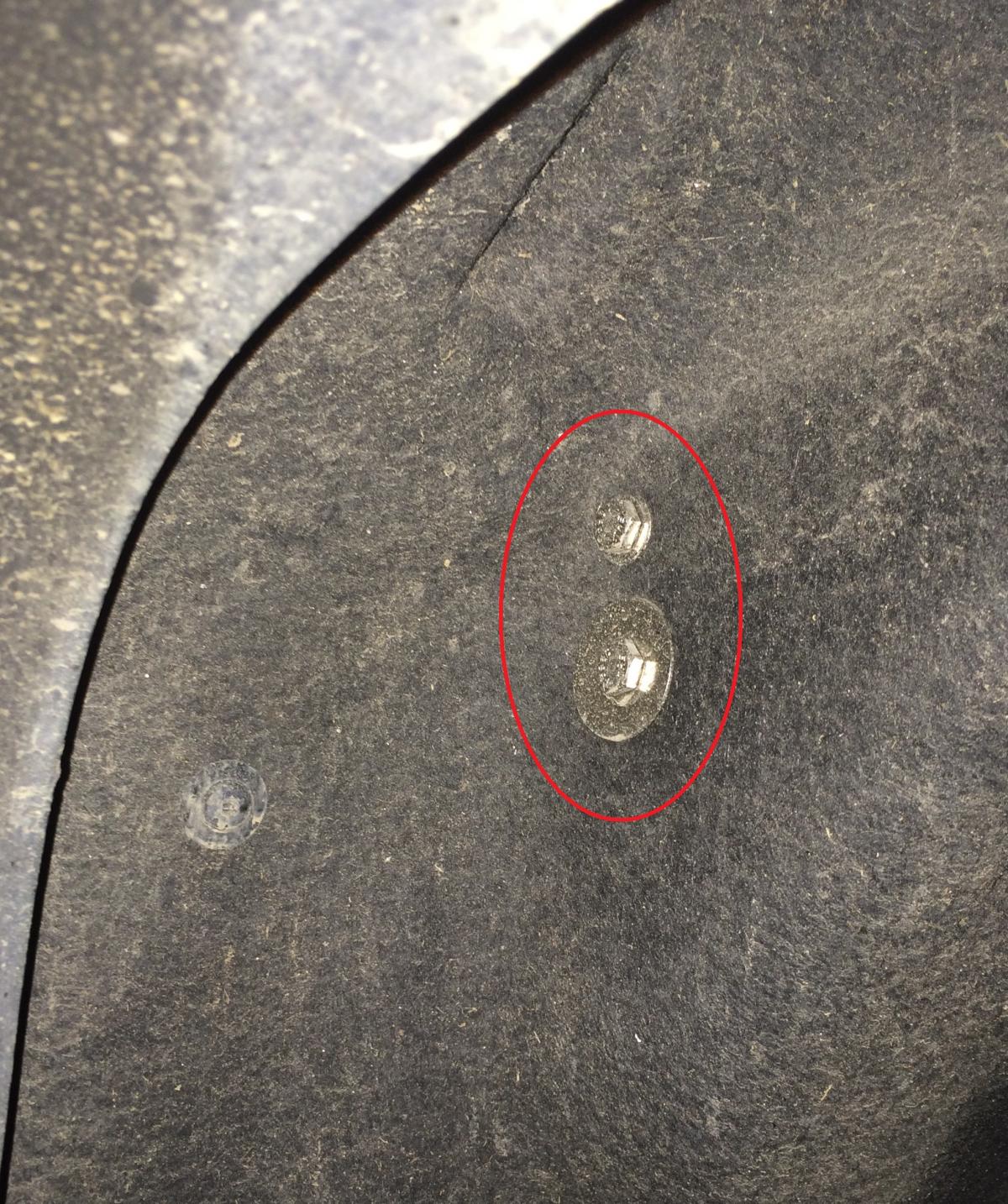

Yes, I did and no problems since. I'd recommend to anyone that buys one, use bolts/nuts from the beginning instead of the self-tapping screws provided.

Motomedic- do you have any pics of the case in your truck, just would like to see how close to the wheel it gets?

I was in a hurry when installing the bolts and was one washer short. That's why, in the wheel well, one washer is normal and one is giant. I'll switch it out one day..... :rolleyes:
Looks pretty good, just curious when your driving around can you hear it bang back and fourth or does it look pretty tight into place?
It doesn't move. It locks into place and releases via pull lever along the bottom
