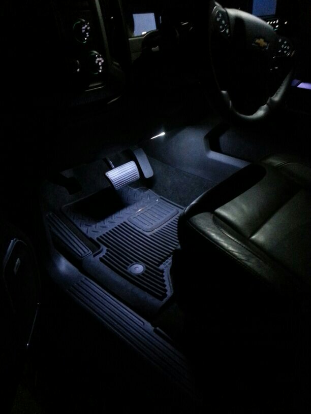

Finally got around to taking a picture of the lights.
Sent from the interwebz by fast thumbs
What lights did you use? I like the brightness yours have. Not too bright where it looks bad and bright enough to light the footwell up
Sent from my SM-N900V using Tapatalk
