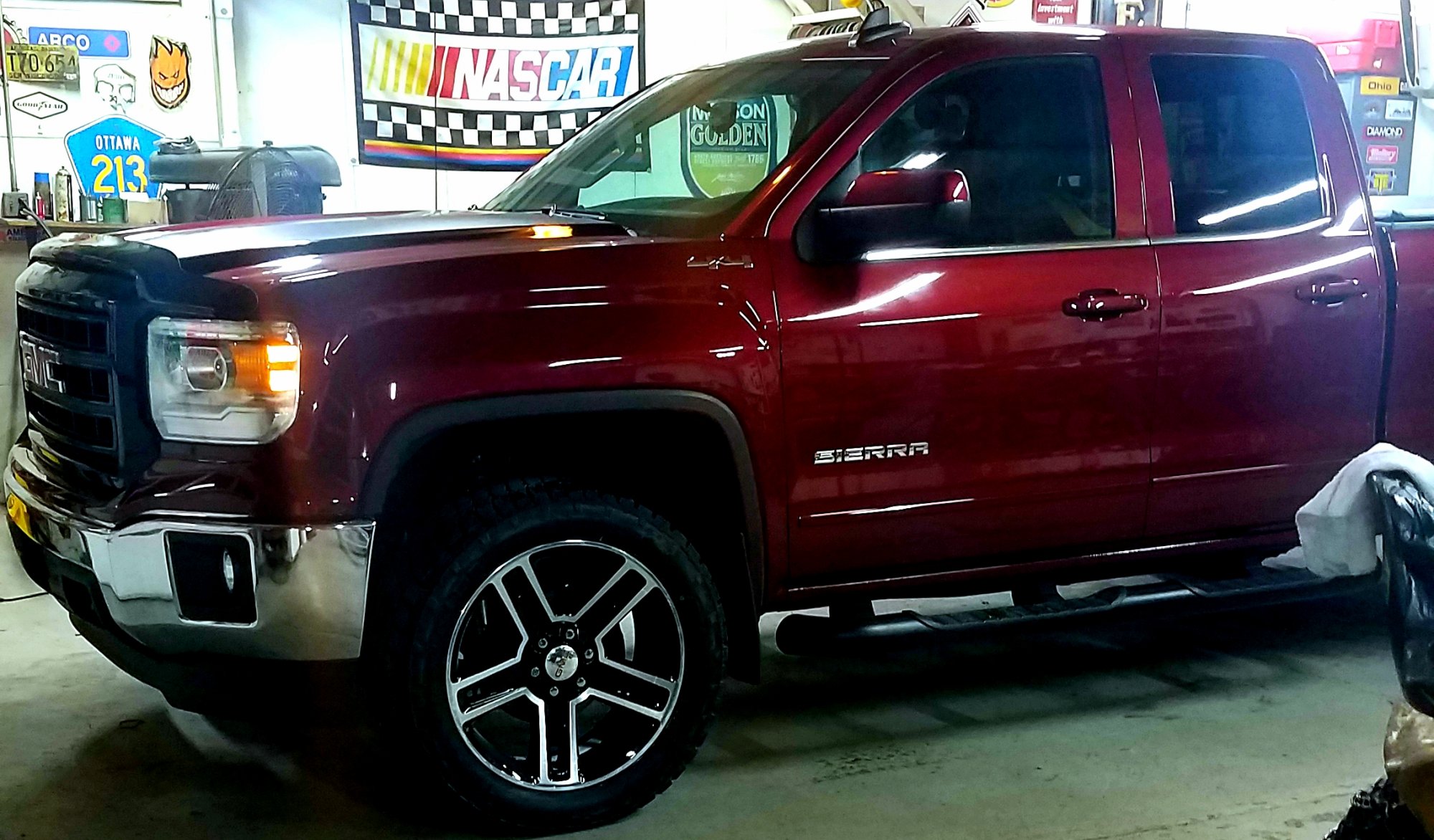

Went with the 285 50s everything cleared just fine. Even the weather techs. Got my running boards back from powder coat today too.

I went with the 285/55/22 TerraGrapplers and love them. This is on a 2.5” RC level with the rear block. A bit of rubbing but after some trimming it’s no problem.
