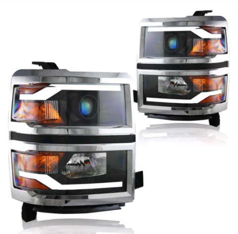

i removed my headlights then you can see better of how the chrome trim is clipped on around the headlight.. unpop it from all the clips then ease it off the headlight as it is adhesive taped on also. i removed the chrome trim off my headlights to see how it would look but im going with aftermarket headlights now.attachicon.gifIMG_4819.jpg
Can you tell me if the black plastic spacer between the low and high beam can be removed without removing the light? how do they come off?
Do I have to take off the headlights to remove the bezel ?
Yes you will have to remove the headlight for removing the bezels. Best way to make sure you don't break one. Took mine off to paint them black
Can you tell me how the black separator strip come off.
To take off the black piece in the middle of the bezel, you have to remove the whole headlight bezel. It snaps directly to the headlight bezel.
