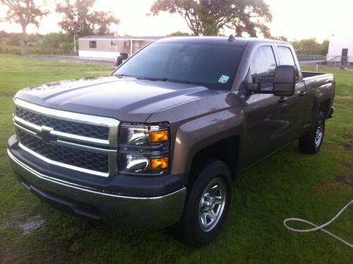

i removed my headlights then you can see better of how the chrome trim is clipped on around the headlight.. unpop it from all the clips then ease it off the headlight as it is adhesive taped on also. i removed the chrome trim off my headlights to see how it would look but im going with aftermarket headlights now.post-135286-0-74454900-1413671150_thumb.jpg
