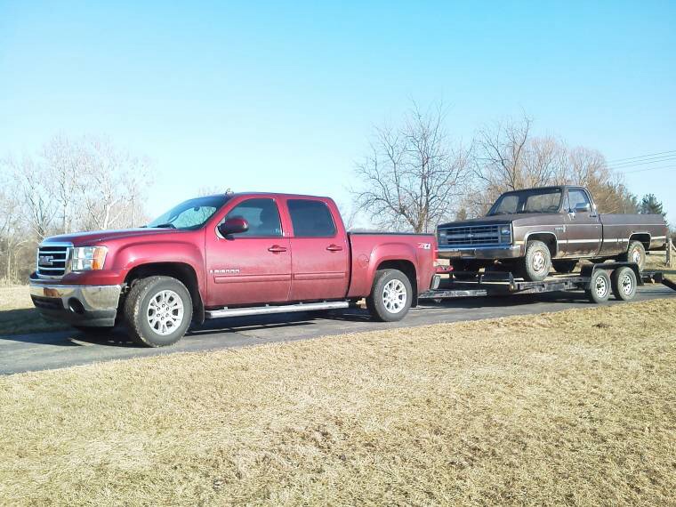

Thanks guys, we have a couple nice days coming so I'll probably work on it and see what's up. Here's a couple pics the day I brought it home. Not too bad for $600.00
Sounds like you got a pretty good deal.It's cost leaves some room to fix it up.I'd love to find a 4x4 like that :)
