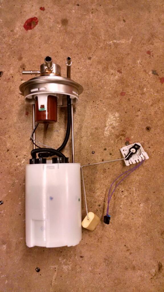

Haha! I'm trying man! Lol! Going tomorrow to pick up a fuel pump, and hopefully I'll have the bed back on this weekend.
Sweet, I need to work on getting my bed off for the fuel sending unit. I have one bolt that apparently is stripped out but won't come out. Of course it's on the driver side so I still can't get to the top of the tank. Worst case I'll lift the truck and drop the tank. All I really want to do is check grounds first before I go replacing anything.
Yea getting the bed off is cake as long as the bolts are okay. I'm surprised mine were.
