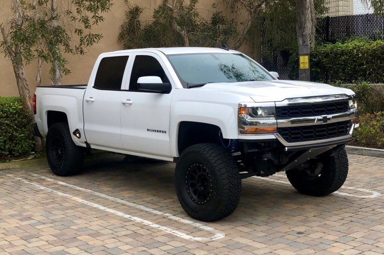

I am on 35's with the Kings turned all the way down (least amount of lift).
Joined the club recently. Swapped procomp coilovers for the kings, should've done kings the first time. Night and day difference between the kings and procomps.
Looks great! Thanks for the reply. Looks higher then mine probably because the front bumper is off.
Thanks! Yeah, having no front bumper make it look a lot higher in the front.
  • 9 months later...
How nose high is it? The picture in the parking lot looks alot more level than the profile picture. Same Setup?
