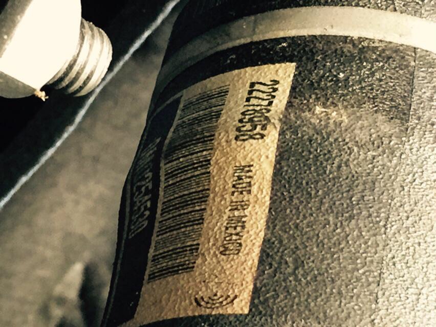

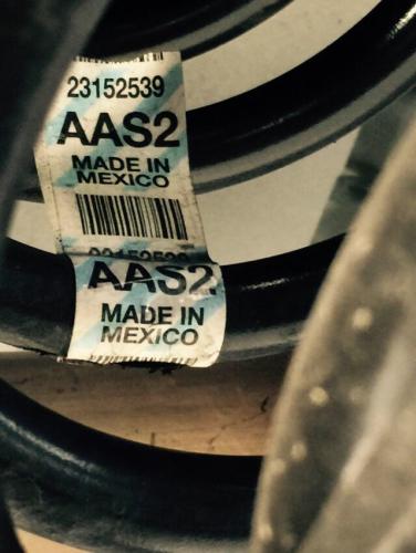

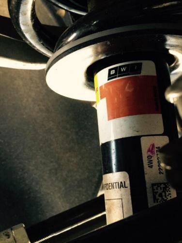

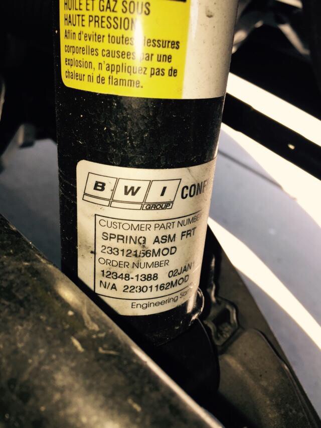

Here's pictures of shocks and springs. Like to find other Escalade and Denalli owners to compare what's on theirs.
I'm having more frustration with the low speed power issue. Driving me nuts.
