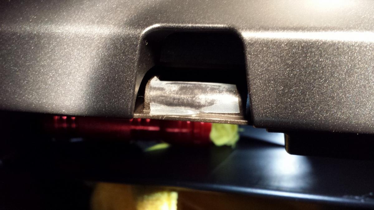

New issue now, anytime I put my arm on the center console armrest the top squeaks, absolutely drives my crazy. It also does it if a passenger puts the arm on the rest. From what I can see it seems the be the plastic assembly that the console latches onto when closed. Any suggestions ?
Had the same problem. Apply anti friction tape to the lower half of the latch.Not sure where you can buy it. Most dealers should have some. It's almost clear about 1/2" wide. You need less than an inch. Put it right on the area that the top latch hooks, folding under.
Good know there is a fix! I'm trying to visualize the area you are talking about, would you mind posting a pic? Thanks in advance.
