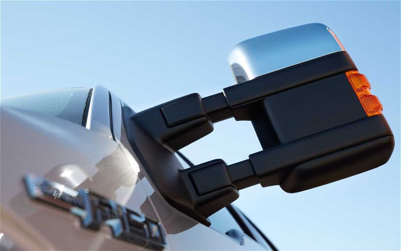

Does anyone have any pics of this mirror? Not too keen on the "new" chrome towing mirror. IMO it looks too much like the previous generation F150 mirrors.

That is the regular small mirror. Tow mirrors are either textured black or chrome.
