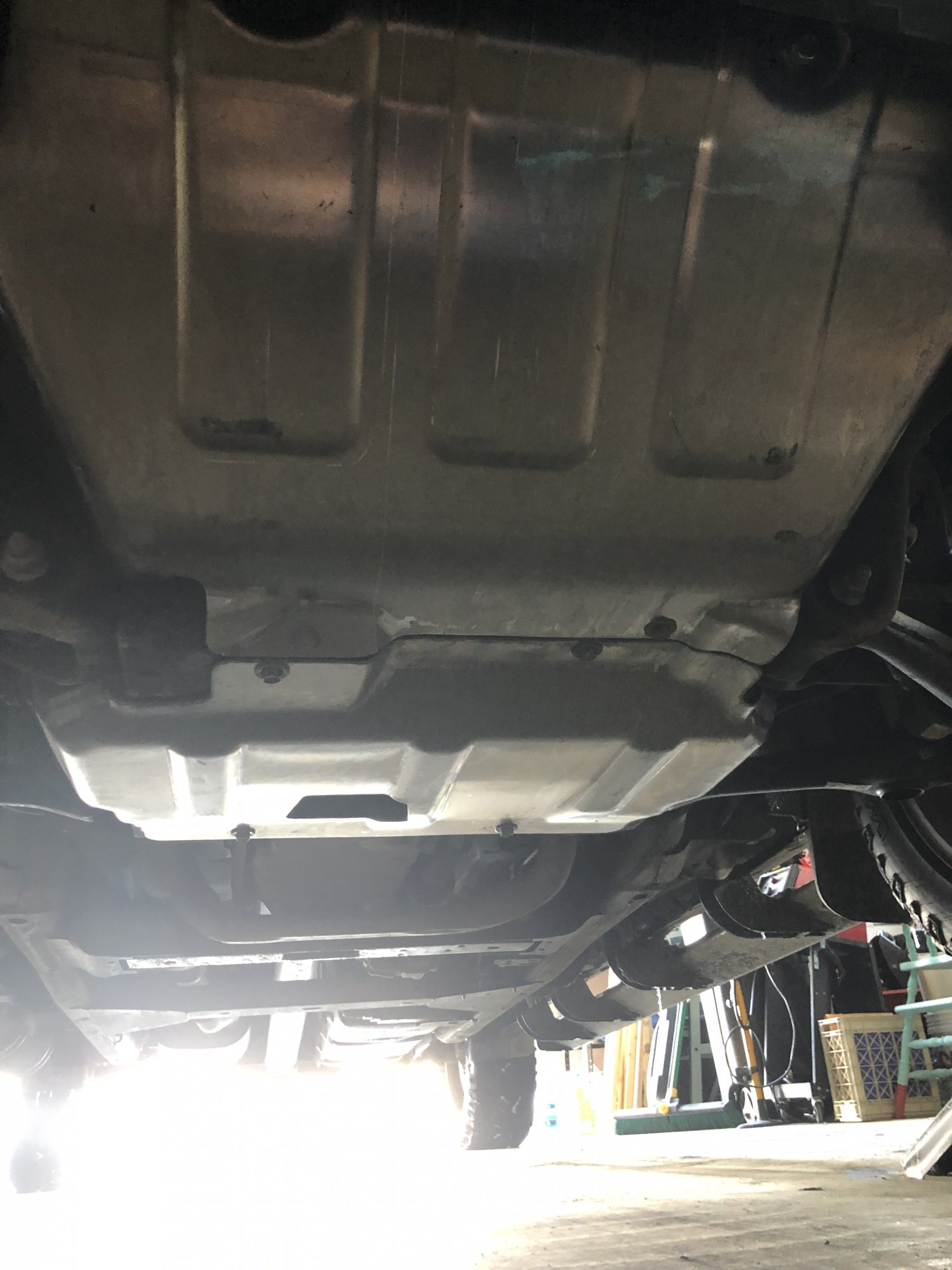

I found the two front skids on ebay for $60 used but basically new. I was really surprised to find out they are aluminum.

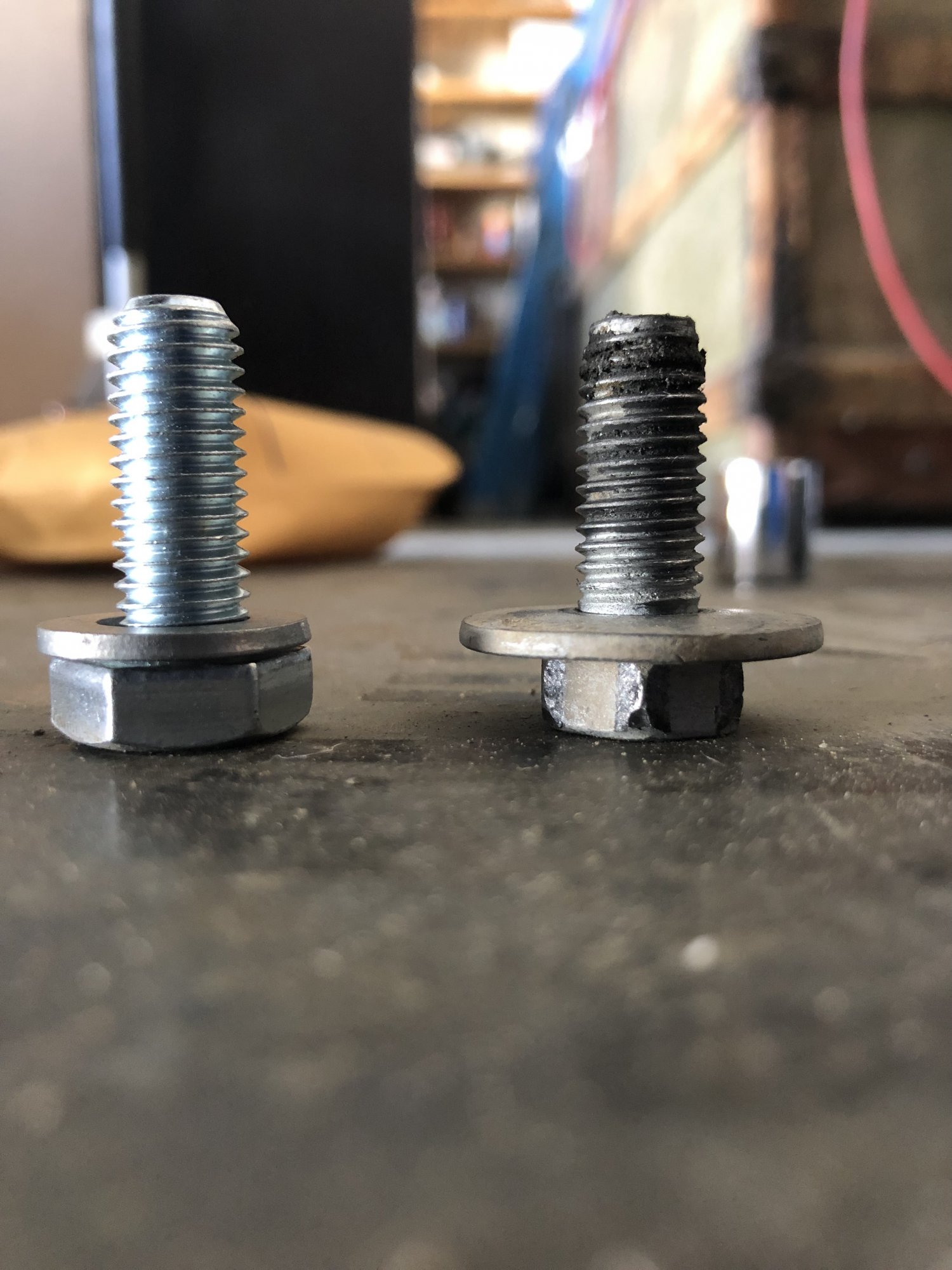

My factory plastic skid was held on with 6 M10x1.5x25 bolts through the metal support brackets. The metal skids need 8 bolts So I bought a few at napa for $0.98 each.
I’m debating whether to get the transfer case skid or not.
Napa bolt vs factory. I had to use my big impact gun to run the bolts in that were not clear from the factory. Otherwise these bolted right on. Great product.

I have the same set that I bought for my 16. Need to get them to the local Line X dealer to see how much to get them sprayed. Then find time to get them on the 18. Bought extra bolts when I got them, were you able to reuse the bolts that came from the factory?
I re-used the 6 factory bolts. I needed 2 more. 4 more if you install the transfer case skid.
Why line-x? These are aluminum, they wont rust. The are shiny and cool and lightweight as-is. I contemplated paint but said F-it and threw them on.
