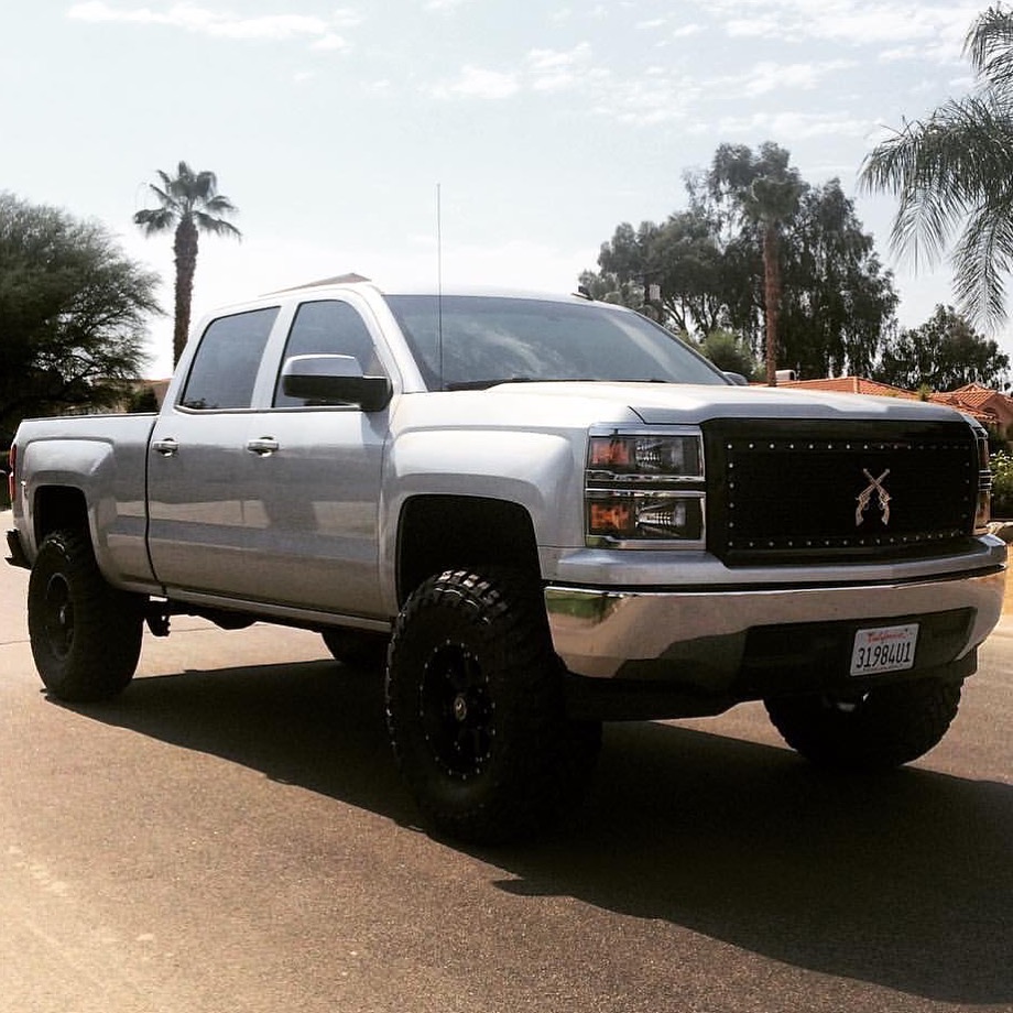

I run 37s with 6 inch BDS lift on my 14 Silverado not sure what gears I have but my truck still can move with a purpose doesn't seem that much slower but now I'm curious to see what I have.5f33287b1c3dfb2de339582f43e197b7.jpg
Great looking truck! Love a big sidewall. What tire are you running and did you have to trim?
