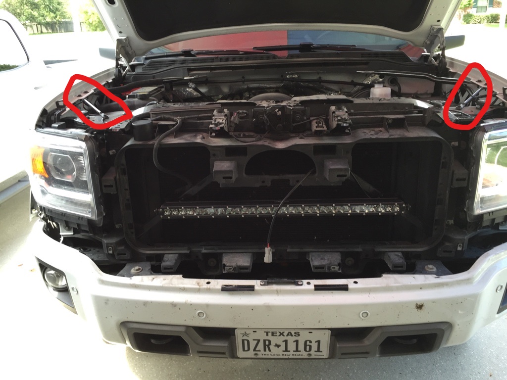

I'm trying to find out what the smaller bars are for on the side of the engine bay, in front of the sway bars. Can't seem to find the part name anywhere.
Thanks!
Thanks!
fender support - But I could be wrong ?? that could be the first time :nonod:
