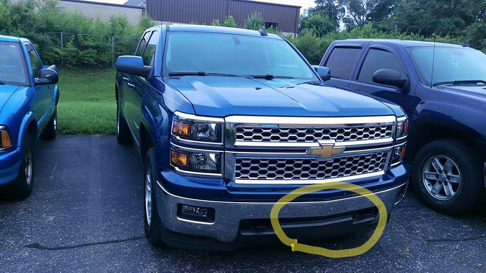

So here is my question. I have read through SEVERAL forums and looked through SEVERAL images. I have a 2015 Silverado 1500. On the front between the recovery hooks (where most people have the license plate bracket) there is a spot the is approx 1 3/8" high and approx 26" long of plastic. My idea is cutting this plastic and flush mounting a bar. I am more interested in lighting up DARK country roads UNDER the snow that tends to fall here in Ohio. Has anyone else had this idea? I have found a few single row bars that are 1.5" high but I have no clue how hot these things get. Would I have an issue with melting plastic if I was to do the custom install to this location??

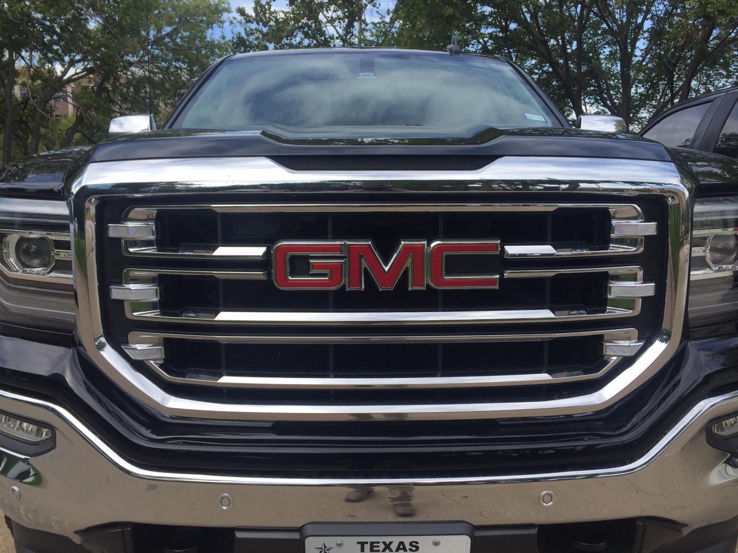

I'm debating doing a 30" light bar behind my all terrain grill but I don't like being able to see the light bar back there. So if I go this route I will use a little trick I've learned from some local law enforcement agencies. You can take panty hose and run it over the light bar and then mount the bar. It makes the light bar much harder to see and still allows the light through. Not sure how much it would affect the light output.

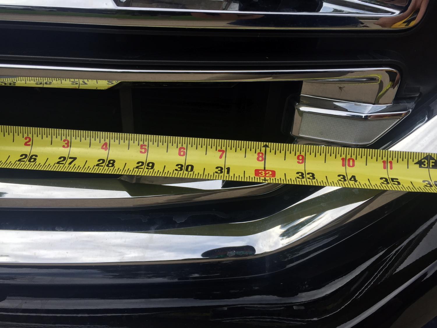

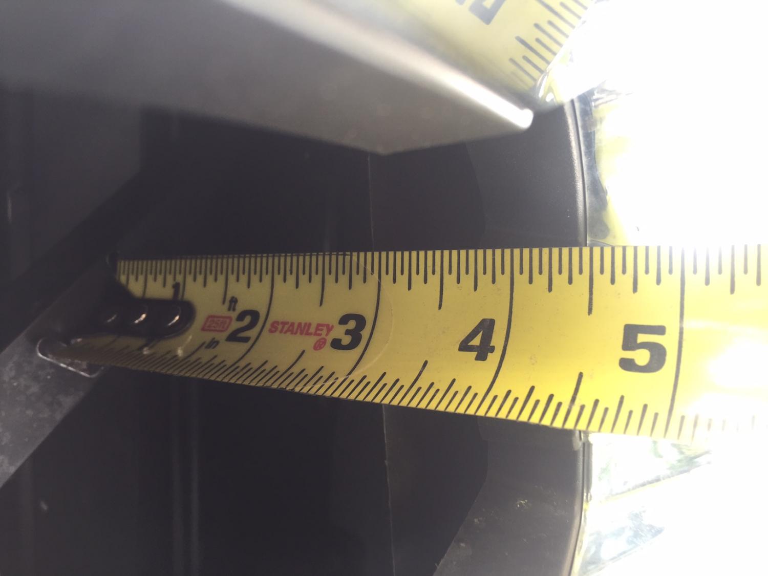

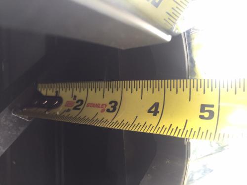

Thus far all the info on this forum has been outstanding. All of my questions have been answered except for a few.
Proper depth of light bar: What size bar will fit in the bottom grill opening of my 2016 Sierra? It seems there isn't a whole lot of depth room in there if I mount it to the radiator brackets like everyone else. Will I have to cut the back side of the grill?
What length will work? And curved or straight?
