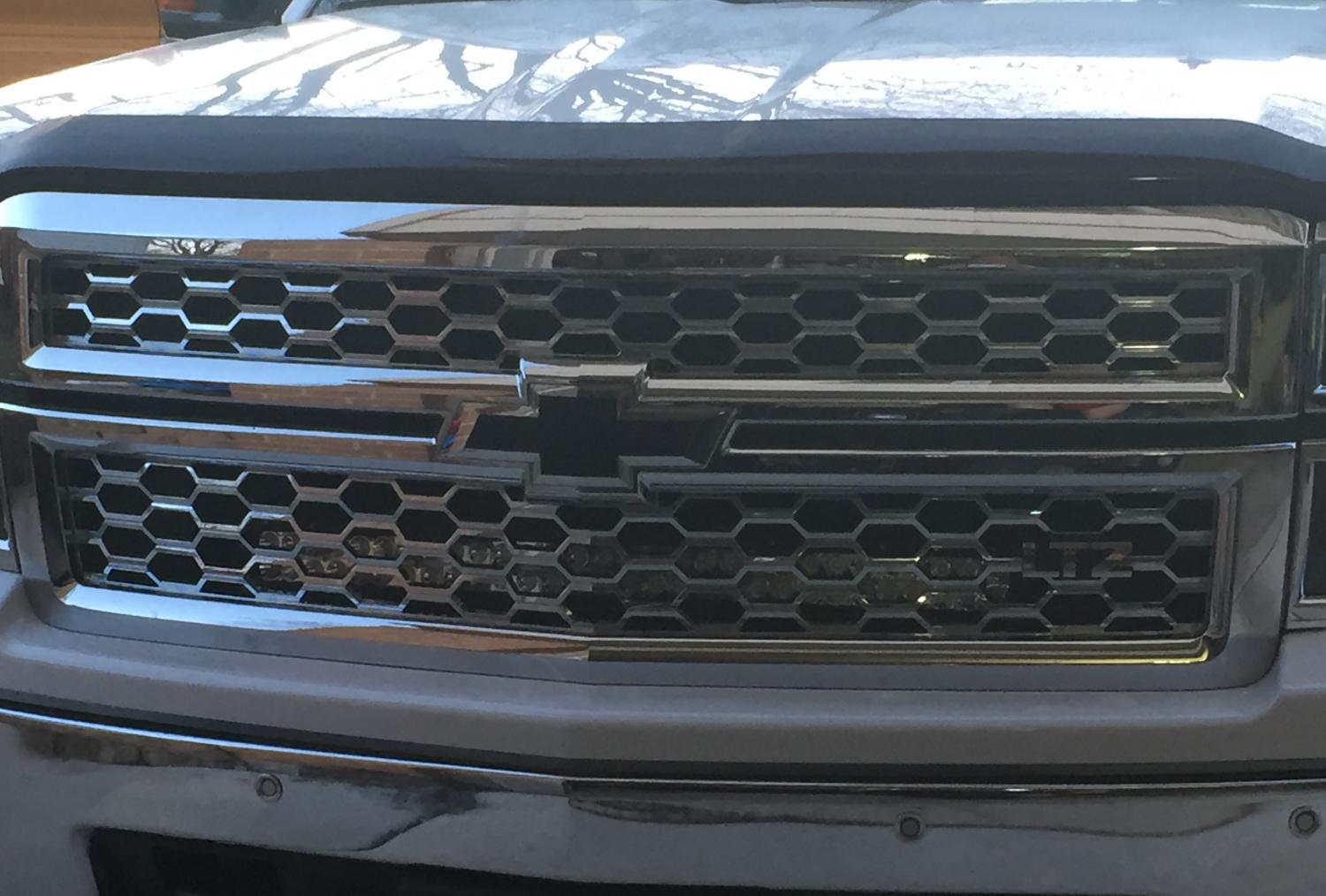

Thanks to all the info on here, install was a breeze. Used a 32" OZ-USA 4d light. Not bad for a $120 light bar. 1df84dbdfa503082ef5ea8139a077cd3.jpg
How do you like the lightbar? I've got the 3D OZ bar. Only difference I can tell visually is yours has more spot and less flood than mine. I like that.
Its good for the price but not as bright as I hoping for. My brothers 20" rigid is way brighter than mine.
I'll rather spend the big bucks on other mods so I'm fine with the output of the lightbar.
