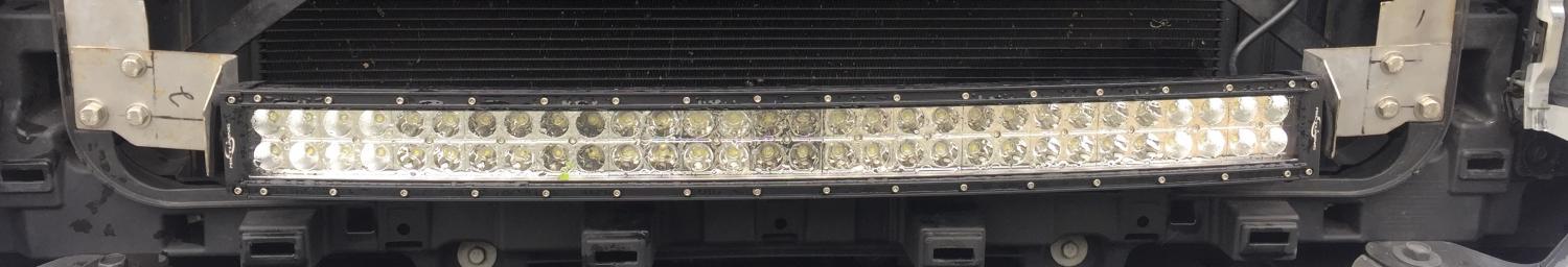

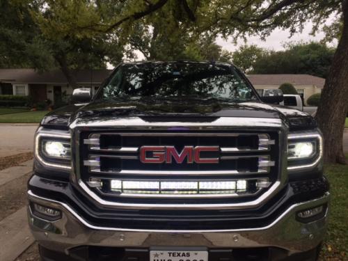

I completed the install of a 32" straight bar behind my grille this weekend. I took several suggestions from this page and I thank everyone for their input. This install was so much easier because of this forum page and I'd love to answer any questions anyone might have.
Here are a few pics

How did you mount it??
I thought we could only get a single row behind the grill of the 2016s but i see what you have and i like it...

I used the mounts that came with the 32" light bar. The angled crossbars behind the grille fell perfectly inline of where the brackets had to mount. I drilled a 1/4" hole and mounted the brackets with a 2" through bolt and locking nut.
Sorry all for not taking any pictures while I had the grille off. When I go to install a single row light bar above this one I will snap a few.

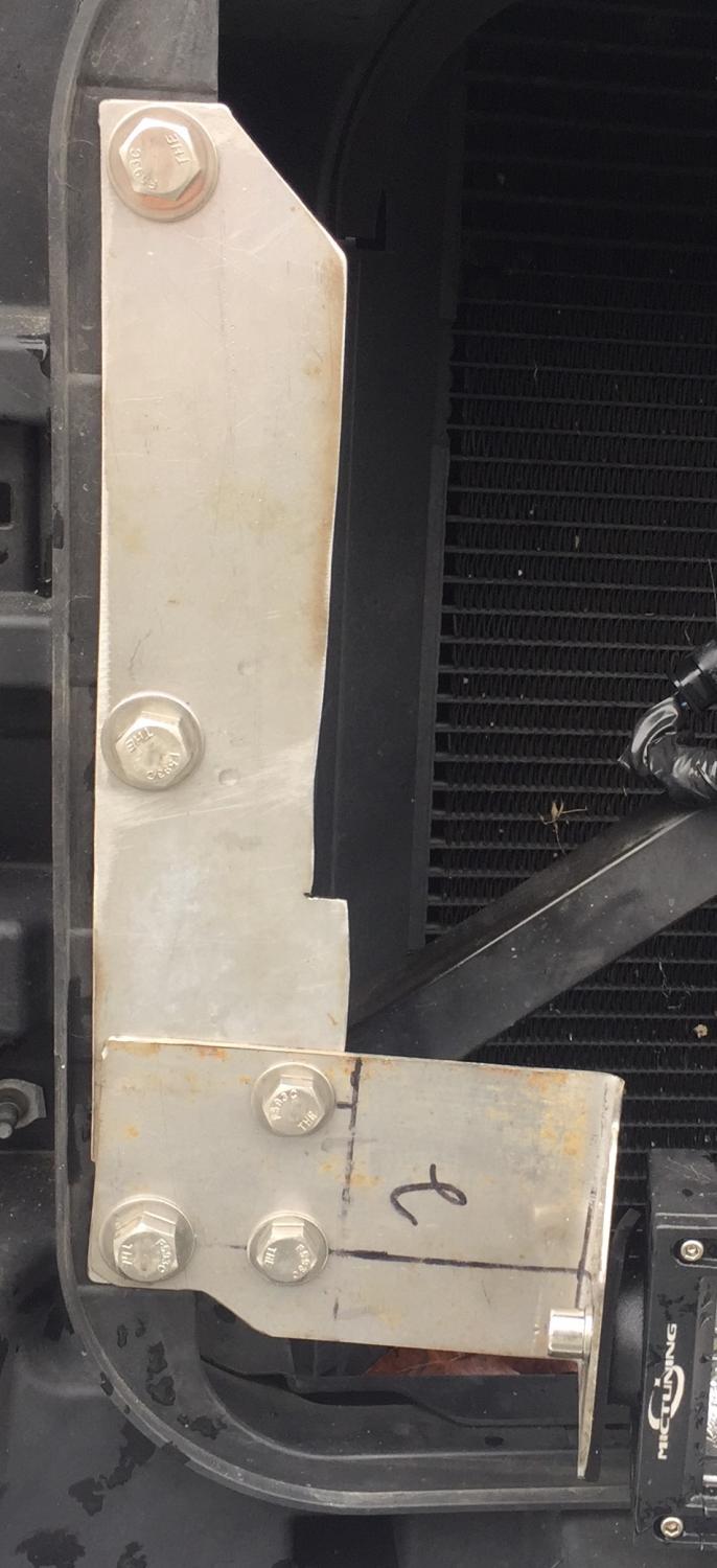

This was my solution for mounting a bar behind the grill. Didn't want to put $285 in to a work truck for the RC mount and bar, so I made one. Isn't nearly as pretty as the RC mount, but it gets the job done. Just some scrap stainless sheet we had laying around at work cut and drilled. Next step is to add some insanely bright LED spots above the bar since everything I've read tells me its impossible to replace the factory HIDs with LEDs.
For anyone that has installed a light bar behind the grill on a GMC with the shutters that move, did you have any over heating issues or is it even possible to mount something in front of the shutters and not cause issues?

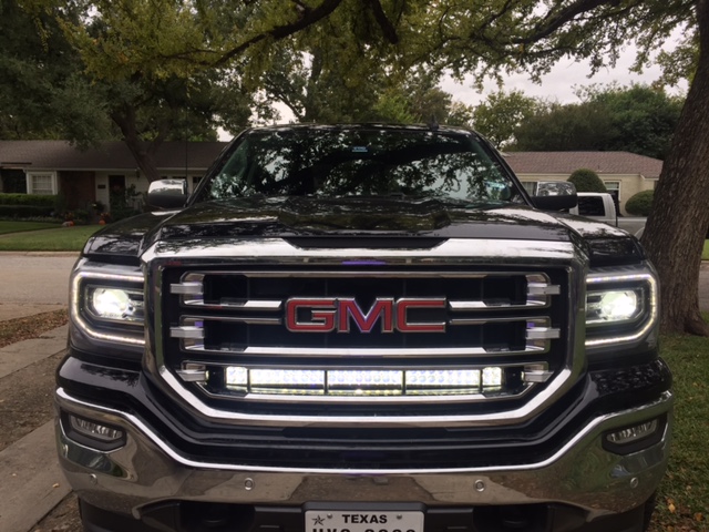

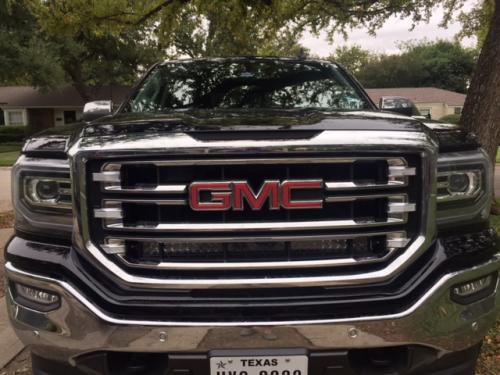

Here are a few pics
How long did it take? Which brand did you go with? and still rummagin through the thread but did you guys find an installation vid on this? I like how your on off button is in the cig port that I neever use
It took me about 3 hours only bc I've never taken the grill off before. I highly recommend putting your switch in one of the cig ports
