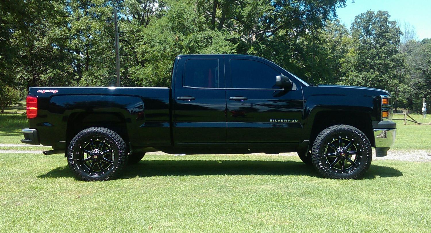

Just adding a pic for comparison if anyone is still thinking about doing this. 2.5" front level only (no rear blocks) and Zone 1.5" body lift. A word of caution that I haven't seen mentioned is be aware that any future bumper accessories you end up adding (brush guard, light bar, etc.) may need modifying to fit correctly as was the case with my N-Fab light bar. Also, you will notice the hitch is not flush with the bumper in th rear if you use the rear bumper relocation brackets.

Thanks z71 Chevy .. Love it.. and the ride is good considering lifting and tires.. for a 4 inch lift can't beat the price

. I did and love the outcome ..tires measure 34.25 and 12 wide ..only had to zip tide fender skirt in one spot ..did rub a little the other day on another part of it and need to zip it..
