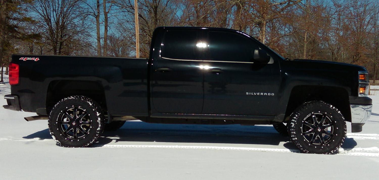

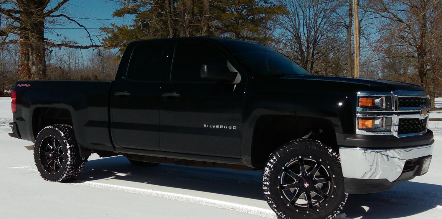

Zone 1.5 $180 for kit and shop near me did it for 300. Did the rugged finder skirts and look amazing .. the ride is good ..also have 2.5 front only..
