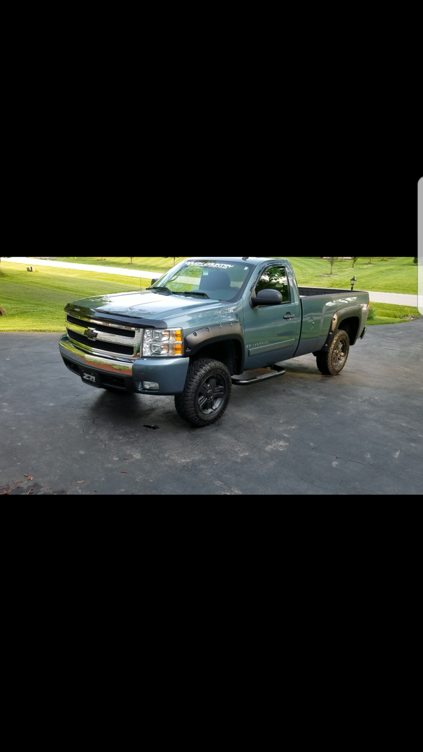

I have a video up on youtube of exactly this topic. Its called 07-13 chevy silverado 1500.I would post a photo but cant figure out how to do it off my phone. I currently own a 2008 chevy 1500 z71 single cab long bed.I have the rough country 2 inch strut leveling kit,and a 1.5 inch zone offroad body lift kit. I used to just run a regular spacer leveling kit,but after putting both a 2inch level and 1.5inch body lift It looks so much better. Im currently running my stock 18s with a 265/65r18 goodyear wrangler duratrac which is 32.5inch. you could easily run 33s with a new rim with correct backspacing and some wheel spacers. I do recommend taking the front air spliter off it makes your tires look bigger from the front. Hope this helps!

This is a pic of my truck finally got it to upload. Has a 2inch leveling kit and 1.5 inch body lift. Running stock 18s and 32.5inch 265/65r18 goodyear wrangler duratracs.
