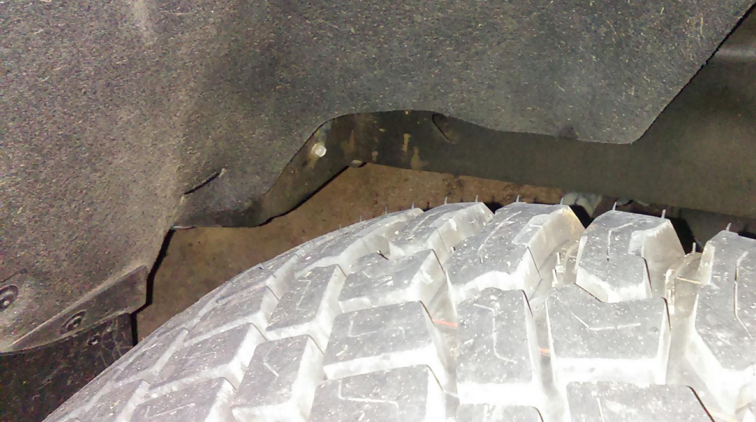

. I did and love the outcome ..tires measure 34.25 and 12 wide ..only had to zip tide fender skirt in one spot ..did rub a little the other day on another part of it and need to zip it..
Any chance you could take some pictures of where it rubbed?

Any chance you could take some pictures of where it rubbeqd?[/quote. Well here is a picture ..funny thing is I zipped tide it before I ever put tires on ..bc I was sure it would hit.. but if you look to right of the picture you can see where it has rubbed that little spot where it's a darker black .. just no time to mess with it yet
