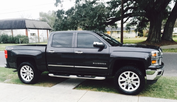

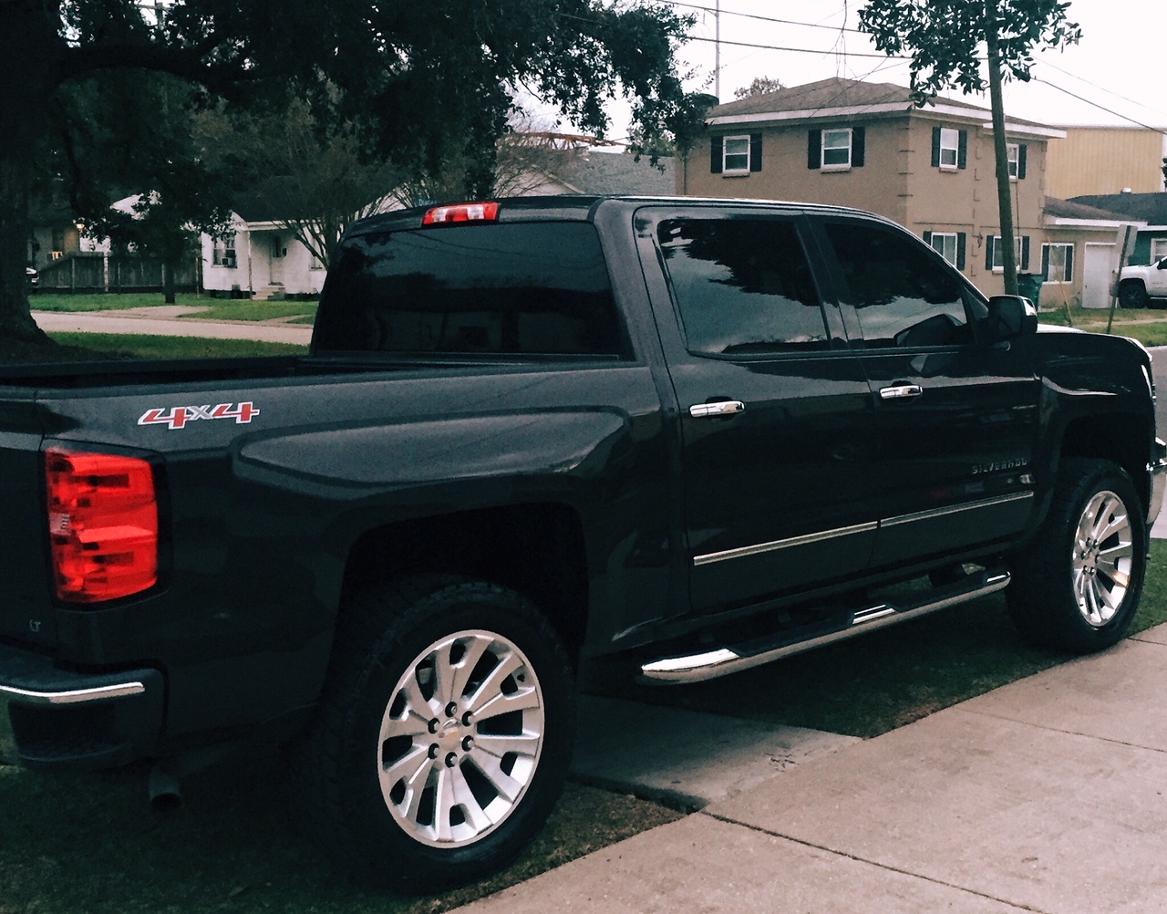

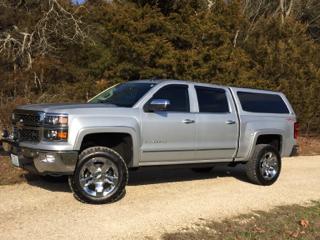

I'm running 285 55 R22s (34.5" x 11.75") on factory wheels with a Pro Comp 2.25" Leveling Kit and Zone 1.5" Body Kit added. I have zero rubbing issues and haven't trimmed anything.

Looks awesome!

wow that thing looks amazing, if it were mine I'd have it looking just like that.[emoji1303]

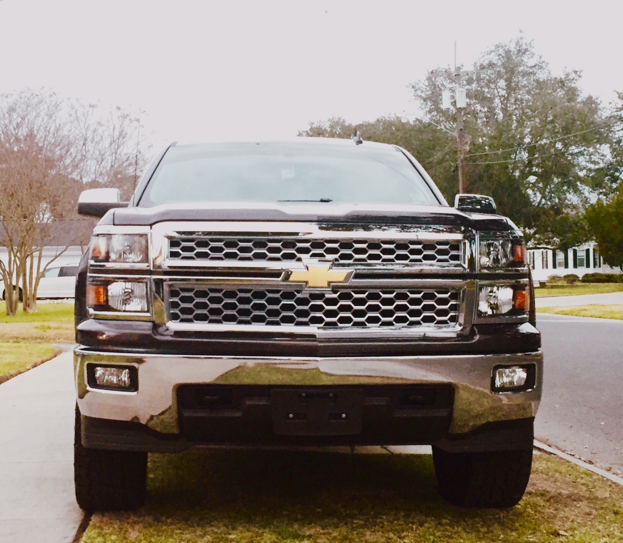

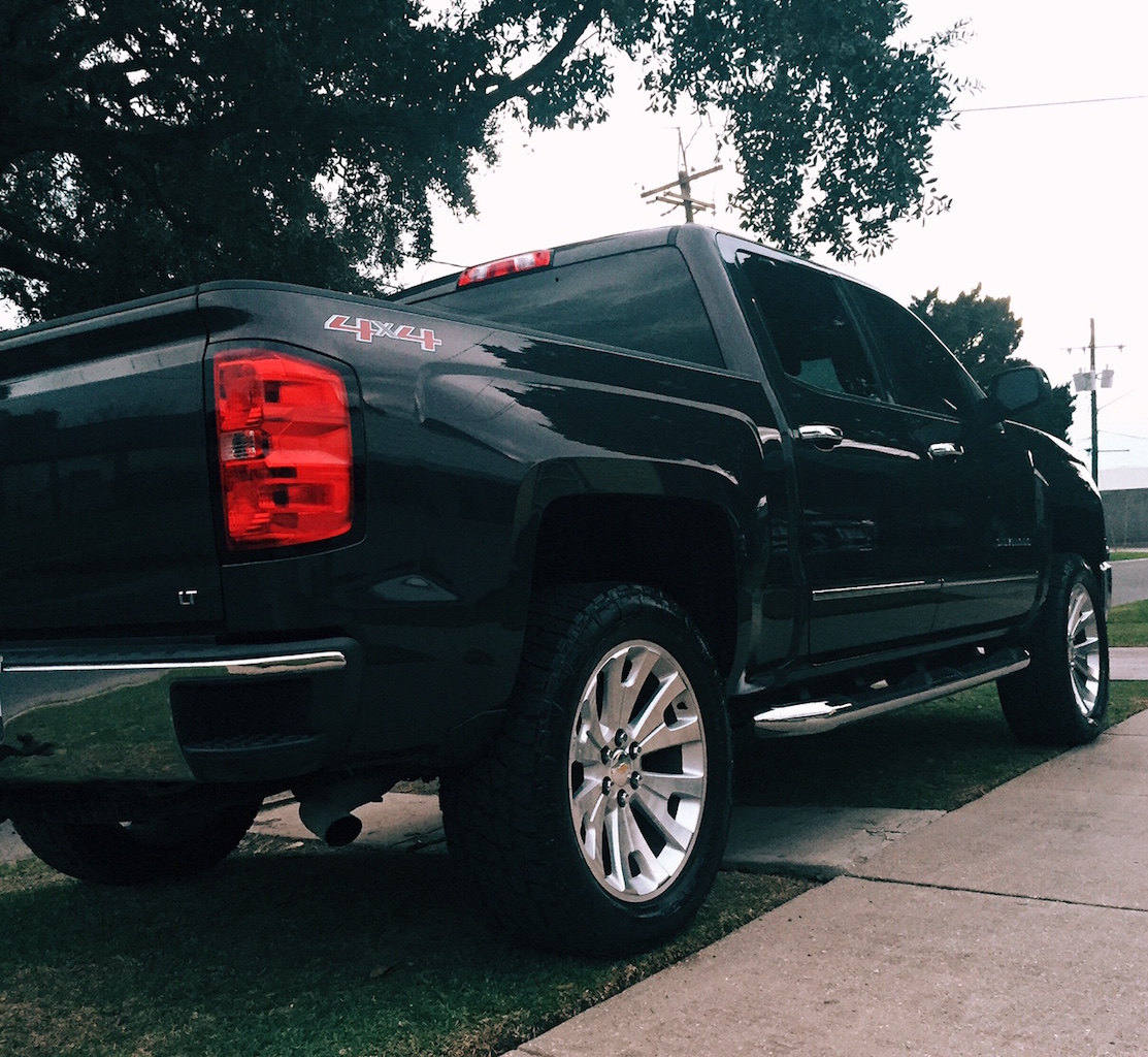

Please post more pics. Your making want a body lift. Do you think you could fit 35 x12.5 tires?
I'll post more pictures this weekend. I think 35x12.50 tires would fit with minor plastic trimming and the right offset that would prevent them from rubbing on the control arms. I will eventually switch over to 20" wheels and run either 295/60/r20s, 295/65/r20s, or 285/65/r20s. I'm confident all of those sizes would work with this set up on 20" wheels.

You should. The kit is $180 from Zone and easy to install. If you pay an installer, they'll charge $300-$400 which still isn't bad. Still has the factory ride.
