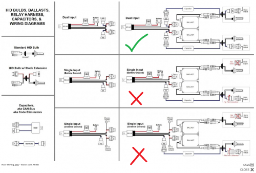

AM I GOOD TO GO WITH THESE PARTS???
Assuming im following the checked diagram

With a 35W kit you will need HID kit, wire harness, and error decoders
With a 55W kit then you should only need HIDs and wire harness.

Bump.... Another question..... in the diagram the top (dual input) diagram it doesnt show a reversed factory input to the HID.... is this a mistake or is there something in that wiring set up that requires it to be "normal"??

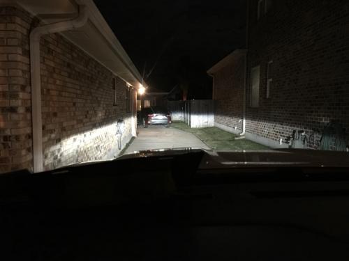

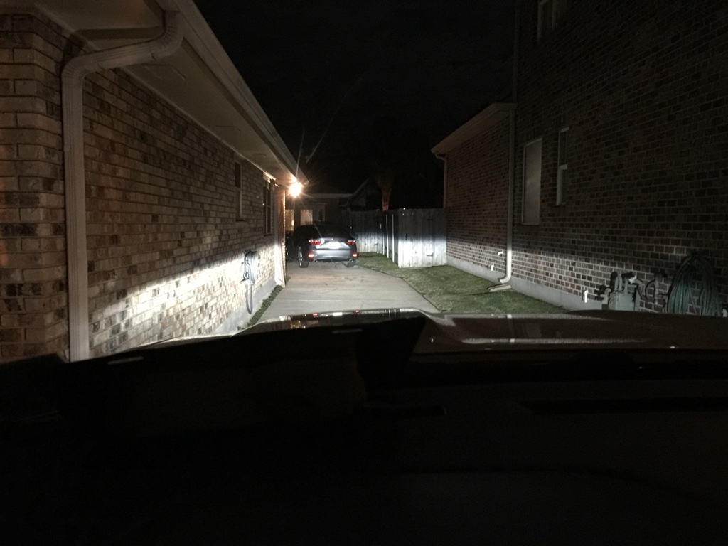

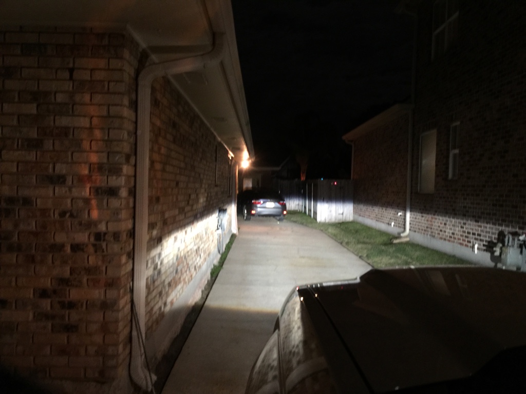

Here's an example of the 55W 5000K in Sierra projectors
First is from outside the truck and the second is through my windshield with 45% tint on it
