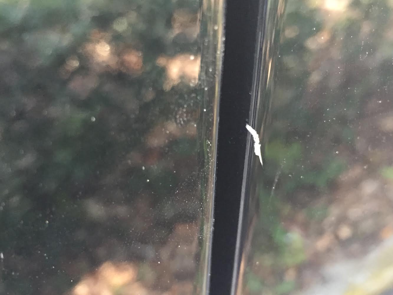

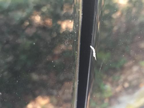

Got my first door ding/scratch 2 weeks in. It is a small half inch scratch on the driver side back door. Anybody have any recommendations? Does that stuff on the infomercials work at all?
I've used both of these with success. Won't be totally invisible, but better than having the scratch.
www.drcolorchip.com
www.langka.com
that sucks!!! freakin hate parking anywhere near other people...something always happens right off the bat though to blemish the perfection. I've been pretty lucky, only a rock chip in the windshield so far. (only a surface pit, not a star chip.)
Kind of miss the old 02 chevy I was driving and didn't have to worry about, now I'm paranoid about everything!
Yeah, it does suck. If it was my old 4runner I wouldn't have even cared. It is only about a half inch long but really bothers me.
I had a door ding dent on my truck while it was still on the lot. They had the "dent guy" come out before I picked it up, couldn't even tell where it was. Contact the dealer you got it from & see what they do in those instances.
PDR guy isn't fixing that one, that will be a touch up only option. A paint and body guy might be able to build it up and then once high enough sand it down and polish it back out, wont be perfect but it will be better than nothing.
What tjay74 said. Body shop will sand the area, fill it with bondo, sand again, prime, and paint the area not to bad i'd say about 5-600 $
So I shouldn't use a sharpie?
No! Go to your parts department and order a thing of touch up paint in your exact color. Most have a pen and a brush applicator and only run you around $10.
Parts department at the dealer? Or any auto parts store?
Dr. Colorchip. You probably will have to do it several times but that is what I would do. Stuff works really well and doesn't leave an obvious touch up spot. I have several smaller spots on my truck that I have used it on and unless you know exactly where to look, you'd never see them. I think it is worth the 30 bucks or so that I paid for it. The touch up paint at the dealership doesn't come close IMO.

Stupid light pole anyway in my case. Best bet will be dealer. In my case, I found the color at Advance but when I did use it, it was a little different color. Looks better than the dent scratch but still not quite as matching as it could be.
